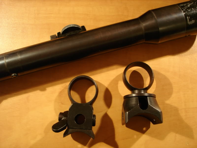

    Gentlemen, you help will be much apreciated. A similar post exists in the gunsmithing section of the CGN forums.
    I have, as many of you probably know by now, a cad scope, and I am now also in possesion of these very well made repro high turret rings.
    I do not have the know how to put these two together. If you have the expereince and know how to do this, please contact me. I will ofcourse gladly pay any and all fees involved.
    Either PM me or email me at Msigismund@gmail.com
    heres a picture of the parts invovled.

    I just realized that these rings are 26.5mm, and my scope is 27mm.....

    You disassemble the scope, slide the rings on, solder them in place then re-assemble the scope.
    Not exactly easy for the average individual...

    the good news is that the rings can be opened up to 26mm by a decent gunsmith. The bad news is you have to disassemble the scope to get the rings on.
    Try contacting gunco in Ottawa in 3 weeks time. They have the ability to do the work, but you'll have to confirm they are willing to take a non-local job.

    Quote Originally Posted by Sigismund View Post
    So the rings need to be machined out to 27mm + the tolerance, so it's not an interference fit.
