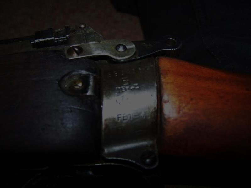

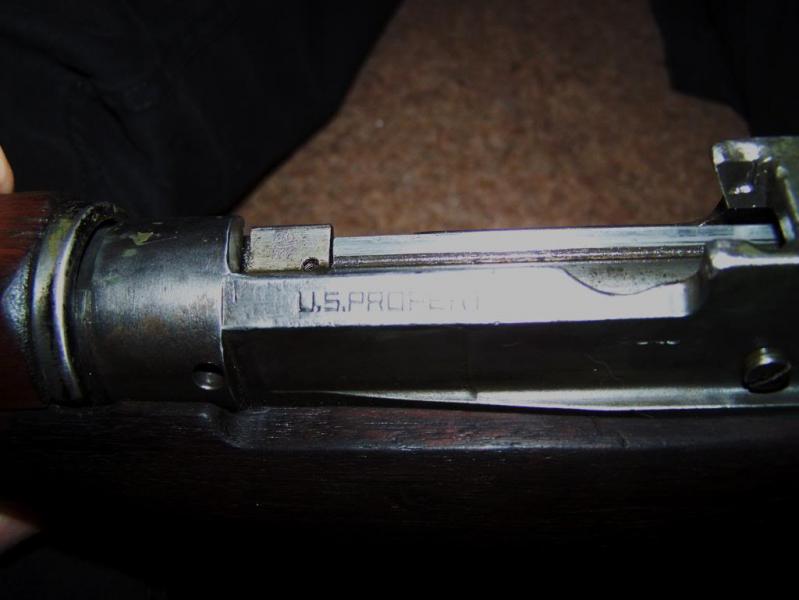

    My first post here, I recently recieved into my collection a No5 Jungle carbine,
    As its the first one i've ever handled / seen. I could do with some advice whether its an Ishapore conversion.
    No4Mk1 has been scratched out on the side of the breech, Its been restamped No5mk1 on the band behind the trigger guard.with Serial number.
    It is marked up Property of the US Govt .
    The sighting block numbers has been sanded down to reduce it from 1300 to 900 yds.

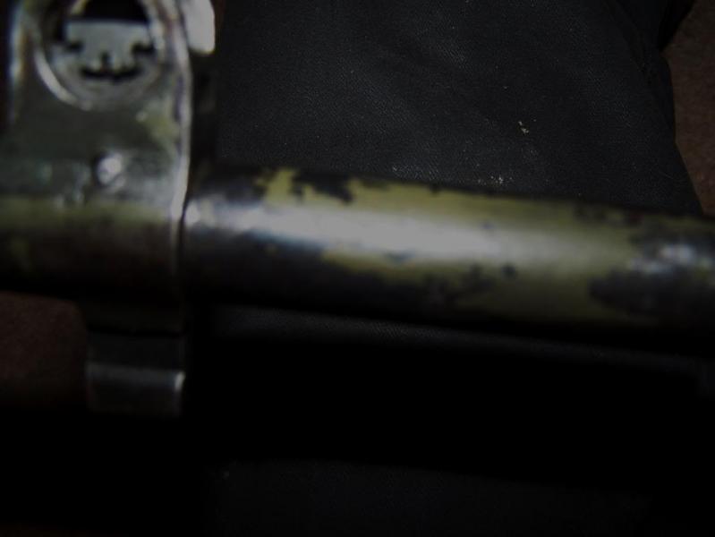

    It has traces of Olive green paint on the the metalwork.

    Hi , don't dismiss your "No5" as a fake . These guns were being used by the Brits after the war in the Far-East and according to the Oracle (Ian Skennertonicon) some armourers were known to be fitting (used) No4 actions to their No5 carbines to help cure the zeroing problem , apparently with some success . The green paint was also a period addition to reduce rusting in humid jungle conditions , so your gun is a seemingly genuine in theatre modification (does that make it rare ?) which was used for popping at commie insurgents along the borders of Malaya/Borneo or thereabouts.....enjoy.

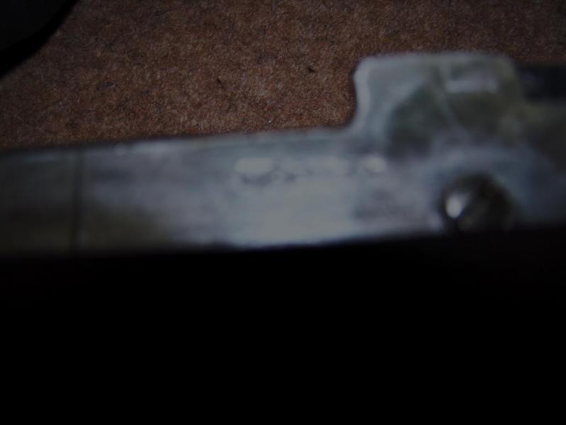

    Quote Originally Posted by pebblemonkey View Post
    Do you have a pic of the No5 MkI stamp? I see the pic of the leftside buttsocket, but I am only able to make out the Savage "S", 1942, and a few letters at the bottom - FE. The S/N and US Ordnance mark (bomb) are too blurry to make out and I am unable to see No5 MkI.

    Hi All,
    I will take some more pictures of the Carbine in normal daylight as I had lots of problems with the flash.
    I don't consider it to be fake , just some RAOC Armourer's recycling/ modifying No4s with No5 parts.(somewhere in some Jungle clearing).
    I failed to mention in my first post that when I stripped it to clean it up the internal metal work had been lightened and so has the cocking handle (milled out).
    My main question is the Serial number will it trace back to a No4mk1 or to the No5mk1.
    Matt

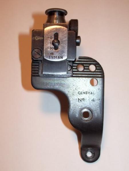

    If you take the wheels, bumpers and grill off a Ferrari Testarossa and put them on a Porsche 911 would you have a Ferrari or a Porsche?
    If you put an American Lyman Aperture Sight on a Australianicon Central Mounting Plate is this an American sight, a Australian sight or just a Mongrel Bastard.
    Without a birth certificate and written proof of WHO your mother and father were you could very well be considered a bastard child of uncertain parentage.

    I'm afraid Pebblemonkey that your ideas of Armourers is somewhat removed from reality......... They haven't been part of the Ordnance system (the RAOC) since 1942 and the sheer notion of an Armourer......... or anyone, doing a barrel change in some jungle clearing is just, well........., believe me!
    Anyway, back to the plot. Check and tell us whether the barrel is a lightened No5 barrel or just a chopped No4 barrel. If it's a chopped No4 barrel then regardless of the FE serial number (it looks like FE1-4? to me), the rifle is someones home made bodge up. I think we need to see the muzzle end of that fore-end too because I'm seeing something that definately ain't an Armourers work. But that's just my opinion
