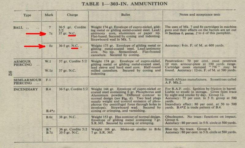

    The only diffrence is 7z was loaded with Nitrocellulose instead of cordite powder and both had flat base bullets, and the 8z had a boat tail bullet.
