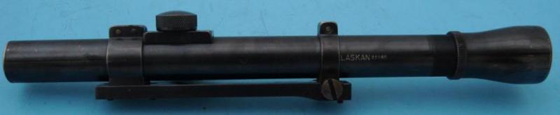

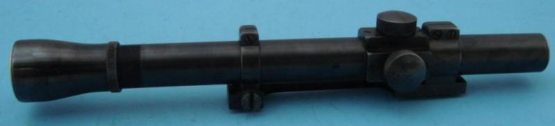

    Today I moved a step closer. I found a Lyman Alaskan scope with the mount and rings. I, of course, cant be certain, but it appears that the mount and rings maybe period correct for the scope. I'll post better pics when the auction house sends the scope.
    Any 03A4 experts out there who could offer an opinion on whether the rings and mounts are like the kind used on the 03A4? Description advised as follows:
    Lyman Alaskan Scope w/ tapered Post Rectile & Redfield Mounts. Good Optics, some loss of blue on the tube.

    Calfed, the base is too short. I suspect it is for some rifle other than a Springfield. The rings look OK and should work on any Redfield or Redfield-type base in conjunction with a 7/8" scope like the one on your rifle.

    ...these 7/8 rings can only be used on old scopes that are not nitrogen filled ( so you can take off the rear bell ) nor have a front bell. They don't split in half to fit around them .

    Good point ... the scope on Calfed's rifle has a 1" tube. i should have specified the Alaskan that was included in the auction.
