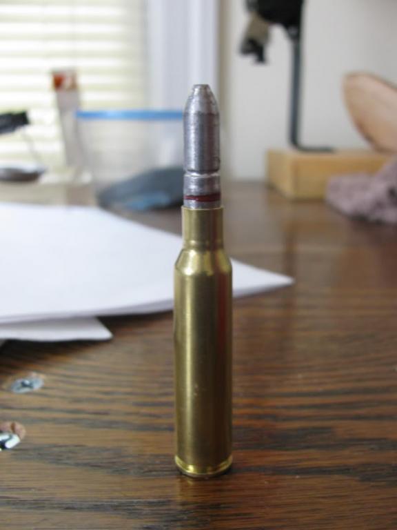

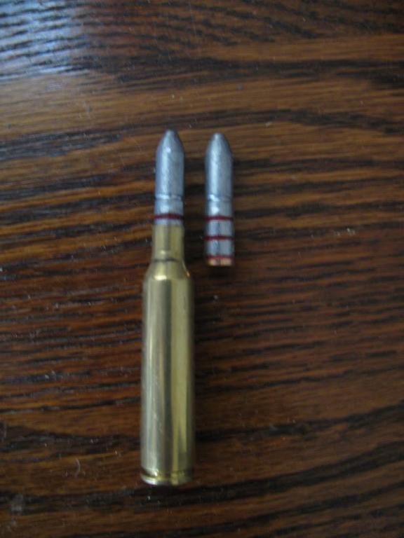

    Cartridge and Bullet Pics!
    Thanks for the suggestions guys!
    Not sure about the Trail Boss though. I've used it with my 1932 Russianicon Mosin Nagant to produce excellent accuracy under Beartooth cast bullets. I was hoping for similar results with my Swede.
    I'm still curious about the LOA. I'm seating the bullets so that LOA is around 3.00 . Here's a few pics.

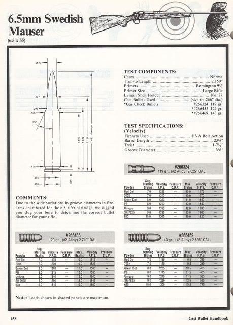

    I pulled out my Lyman Cast Bullet Handbooks and they show several reduced loads, such as 7 - 9.5 gns. of Red Dot with their 143 gn cast bullet, with a LOA of just 2.825. I understand your suggestions so far, but couldn't there be a problem with seating depth as well causing the key-holing? Or am I way off base?

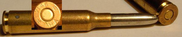

    What is the major diameter of your bullets? What is the diameter of the nose section ahead of the forward (unlubed) groove? What is your rifle's groove diameter? Throat diameter? Without knowing these critical dimensions, we can't give much specific advice other than to try a much lighter load (about 8 or 9 grains of Trail Boss) in the hope that lower pressure and velocity will alleviate the deformation that's causing instability.
    To give you an idea of the bullet configuration for which these rifles are throated, here's an example of a 6.5 round with the original-style bullet -
    As you may see, the bullet is very long and its ogive short. This requires an extended freebore to allow chambering.

    Parashooter has posted an excellent photo of the kind of bullet that performs well in most old service rifles. I have just about given up trying to use lead bullets with nitro powders. The results have been keyholing, leading, and just plain lousy grouping. But the long type of bullet with short ogive gives the best lead into the rifling with chambers and throats that are often overlong by modern standards. Please do not forget, we are talking in many (most?) cases about rifles that were built long before the CIP/SAAMI standards were derived.

    aprayinbear, just two observations about your lead bullets:
    1) in your 2nd pic, I think I can see a size reduction about halfway between the first and second grooves. You could check that with a micrometer or good slide gauge. So maybe your bullet is intended to be nose-riding.
    2) But why is the first groove empty? What is it for, if not to hold lubricant? How about getting some lube into that groove?
