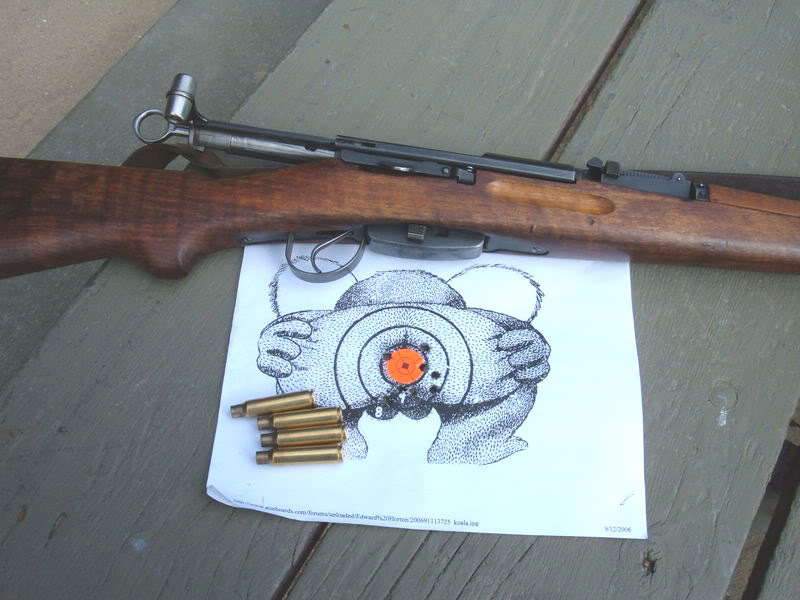

    I have only shot the 168g Sierra Match King so I have no other data. But it was good shooting to 300 yards on some steel plate.
    Here is a 100 yard fur ball.
    Cheers.

    MJ1, that's probably the cleanest K31icon I've seen. Was it one of the recently released police issues?
