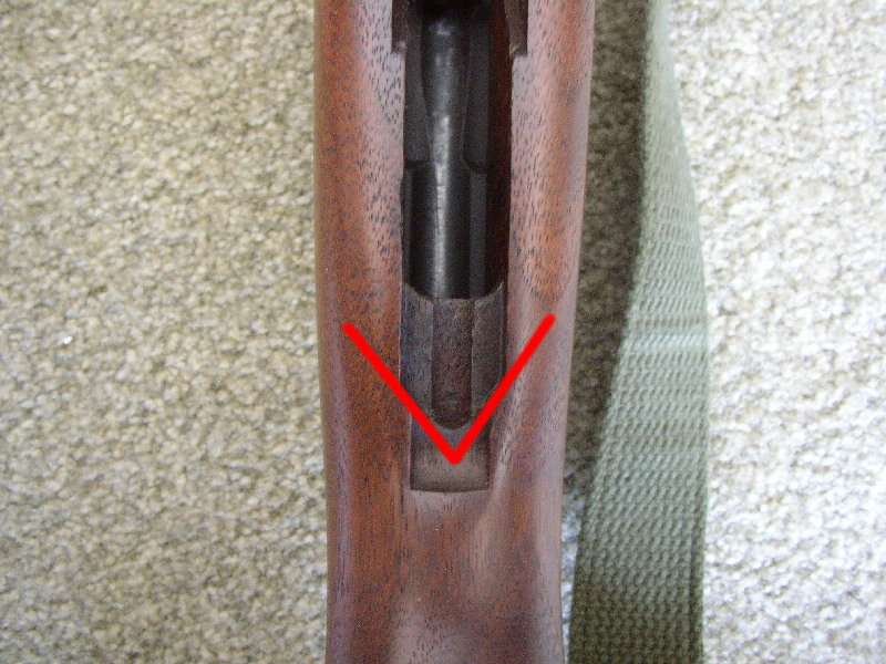

    That is clearly Overton stock {see partial v-notch} and the arched star DAS that matches the late 5.6 million to end Sprinfield. Rick Bicon
    ---------- Post added at 07:59 PM ---------- Previous post was at 07:57 PM ----------
    Overton most proabbly roughed in the blanks and HRA finished it out if it is a HRA but the DAS is very confusing. Rick B

    I believe you are correct Sir, the angle is steeper than the angle on an SA Stock, and we know it's not a Winchester. I never enlarged that picture untill you pointed it out. I have an Overton stock on one of my Garands, but it's birch.
