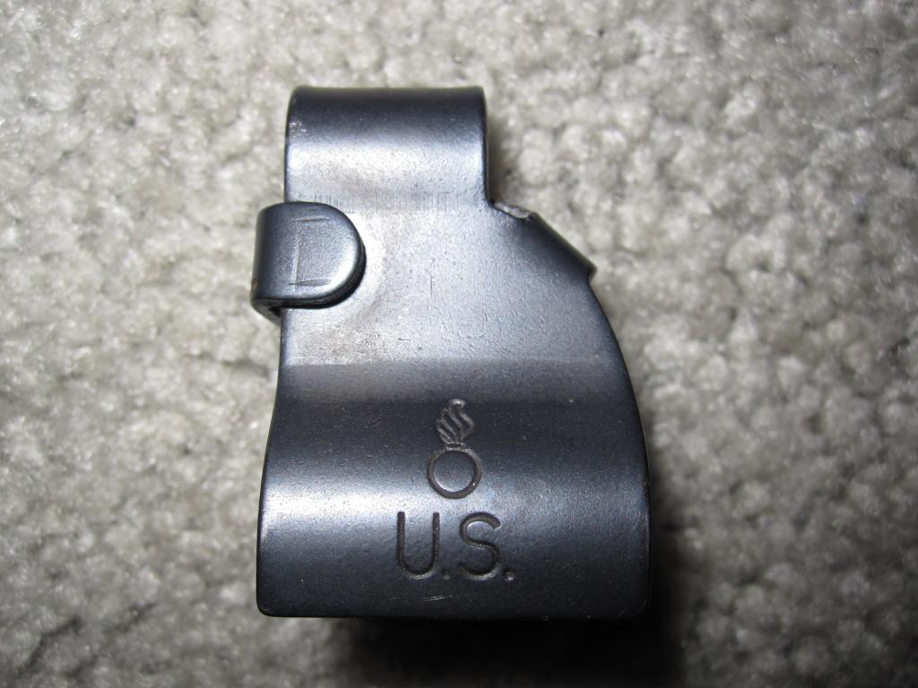

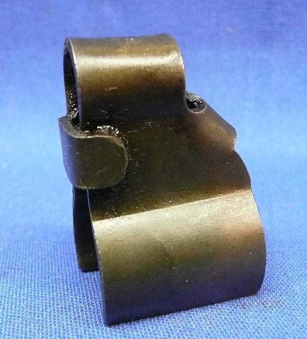

    Look at the 2 pics below. They describe what John mentioned. One has a radius and another has a definite crease.

    So the upper pic is fake? It has the crease. Thanks for the pic. I'll try to post a pic of the fake I got.
    I noticed the originals seem to have stampings with wide flat bottoms in the recesses of the letters. True/false? The hood I have has the d*mn dot matrix stamping!
    Any other repros floating around out there? Sling mounts,sights,buttplates,etc. we need to be aware of?
