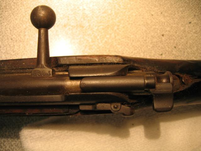

    Help identify this Jap please

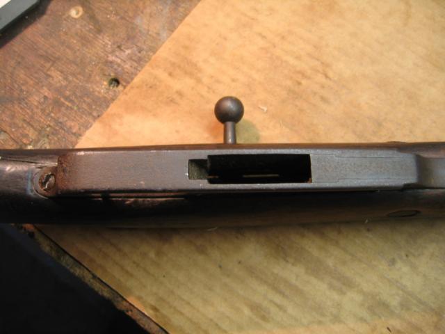

    aquired this last nite, not a Jap rifle guy but thought that stock marking was way cool any help would be appreciated, thanks guys

    Mauser Gew 88 - not Japanese
    I don't think it's a Japaneseicon rifle!
    It is definitely a Mauser Gew88 rifle - this can be seen by the style of the bolt catch and the bolt assembly (striker nut).

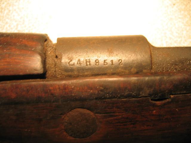

    The bolt number does not match the number on the receiver.
    Looks like it was acquired by the Chinese and remarked. Loewe and Steyr both sold Gew88s to the Chinese.

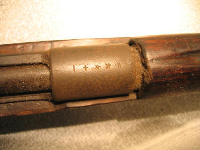

    Reading the markings on the receiver/barrel ring from the barrel end back, we have:
    double stroke = 2
    "stick man" = 6
    star = Nanking Arsenal
    + = 10
    - = 1
    (or, unfortunately, it could be the other way around!)
    Please post a pic of the entire rifle, and any other markings you can find!
    Patrick

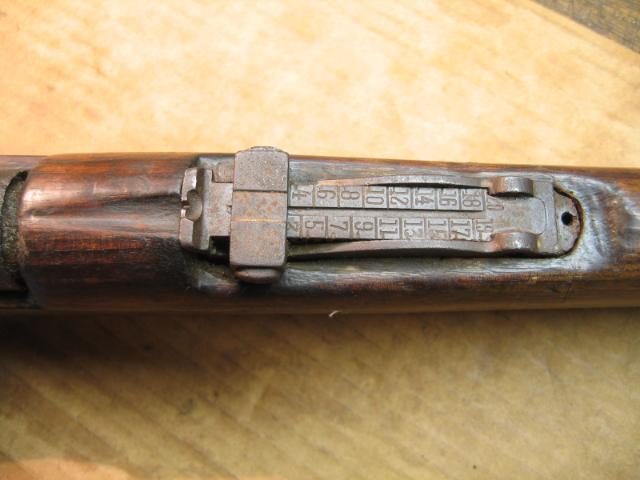

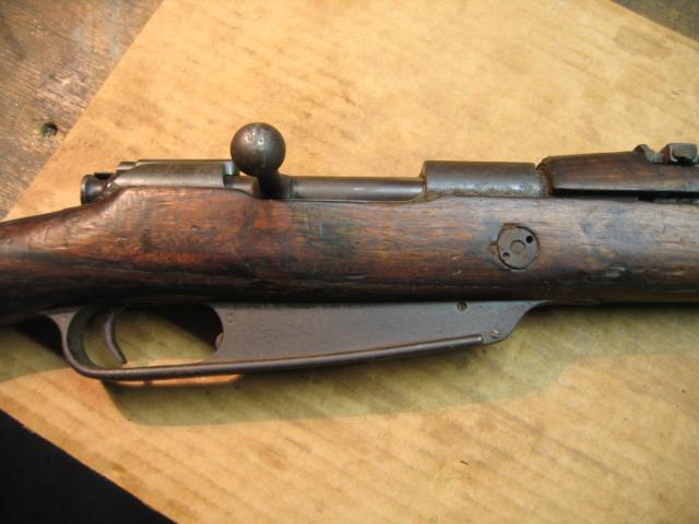

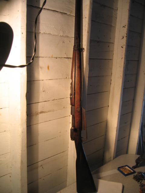

    here you go Patrick, what caliber would this be? standard 8MM? any real value??

    just looked on google, it's a GEWicon 88 copy called Hanyang 88 made by the Chinese, you learn something new everyday, Sal

    Yup, that seems to be the beastie! Caliber should indeed be the 8x57IS. But check it anyway!
    I once scrapped a Chinese G98 rifle - the quality was awful! I would not assume that earlier Chinese rifles were better. So if you are thinking of shooting it, go very, very carefully. You can find enough tips on these forums about checking out old service rifles, but if you have no experience with old, dubious rifles, I suggest you meet up with someone who has that experience, and go through it together.
    Patrick
    Sep 2008
    06-25-2023 @ 06:36 AM
    5,032
    05-11-2025
    03:06 AM
    Hanjang Type 88

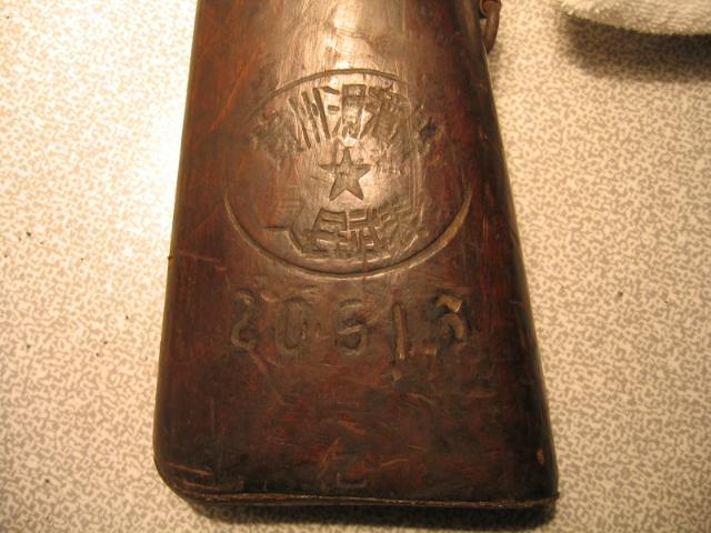

    Apparently the Chinese were still producing these rifles when the Japaneseicon invaded and the arsenal had to be dismantled and moved back from the danger zone. Bearing in mind what I found when I scrapped the 98 "Chiang-Kai-Tschek" rifle, I would regard this as a probable wall-hanger.
    But since these rifles were used as far back as the Boxer uprising, it could be very interesting to find someone who can read Chinese and decipher the butt markings. Who knows what it might say? "Death to all imperialists!" maybe, or "Make will before pulling trigger"?
    Patrick
