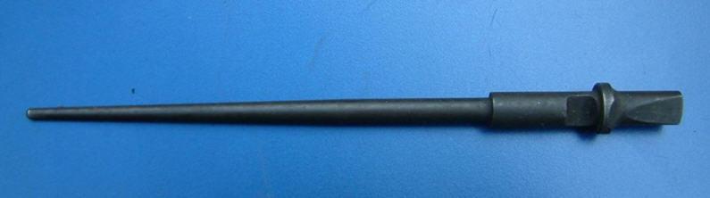

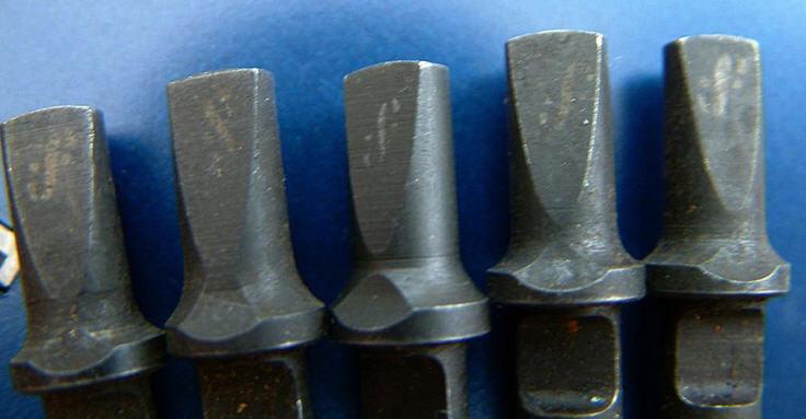

    I am trying to ID a marking on some early one piece SLR firing pins.
    The marking is a sort of stylised 'f' that is etched on.
    Can anyone ID the mark please or give any info ?
    Many thanks KG

    I would say without a shadow of doubt that they're from Fazakerley. Being late 50's or early 60's production I think that the two piece firing pin was probably modification 1 or 2.

    Thanks Peter,any idea when Fazakerley went over to using this mark ?

    Thanks Peter, that's good to have it confirmed as Fazakerley, I have seen other parts with the same stylized etched marking.

    They won't have been using it for long as they quite justifiably had the rug pulled from under them before they got too far with L1A1 production. I seem to recall that the biggest part they got around to producing was trigger mech housings and even then there were thousands rejected that had to be rectified at BSA when they took over from Faz
    Incidentally, the Government were so frightened of the consequences of the workers taking over the factory that the Security 'arrangements' at Fazakerley involved an Armed Police there

    Maybe this etching mark was used on parts in which stamping 'F' was impractical?
