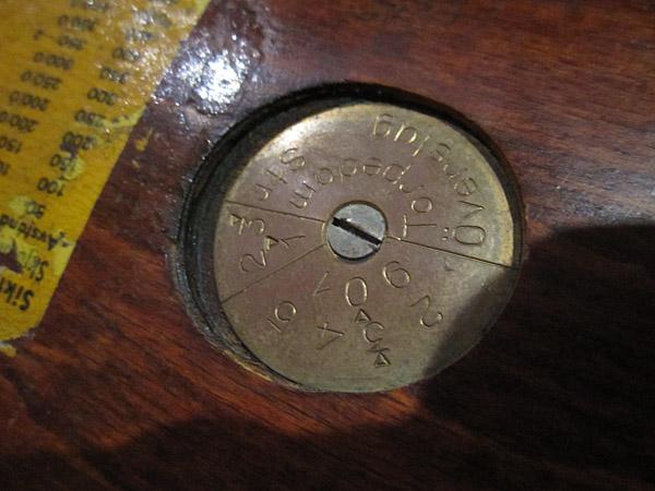

    Enough talk, a few pics. If anyone can interpret the disk I would be grateful !

    This is an early version of the stock disk. Yours indicates that the rifle was originally made with a 6.50 mm bore, and a condition 1 (new) bore condition.
    It has been inspected later, and the bore is measured at 6.53 mm and condition 3 condition. The Swedes were quite strict on bore conditions, and tend to overstate the condition of the bore as to what we might consider here in North America.
    Condition 3 (the smaller pie shaped sector) is indicative of small spots of rust in the bore, with no sharp edges to catch anything on, but the rifle is still in very shootable condition. In other words, the barrel may be dark, but the lands and grooves are distinct. This does not indicate that the rifle is in poor condition, only that the bore shows some wear and or rust/corrosion, but is very acceptable for use and shooting with no problems. There were 5 grades of barrels, and the Swedishicon Military never used weapons in poor condition.
    The "Torpedam" on this disk identifies it as an older disk. Newer disks have "Torped". This refers to the pointed boat tailed m/41 bullet. "Overslag" means over. "Str" means Streck, a unit of measurement roughly equal to 3.6 inches at 100 Meters. There is no number in the space between the Overslag and the Torpedam, so no compensation is indicated for point of impact for the two different Military type of bullets the Swedes used, the 156 grain m/94 round nose, and the 139 grain m/41 Spitzer bullets. If, for example, there was a "1" stamped in this space, you would aim .1 meter high (3.6 inches) at 100 meters when using the older, round nosed, m/94 rounds.

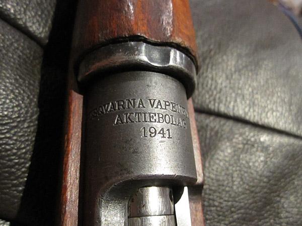

    There are two things you might want to take notice of. First is that the rifle is a Husqvarna 1941 date, and the bent bolt handle. This is correct for this rifle. A little over 28,600 rifles were made during this year.
    The second thing is what puzzles me a bit. The stock disk may have been changed. As I stated, this is an early stock disk, and the Husqvarna produced rifles were the last ones made in any mass production of the m/38 or m/96 rifles. As such, you would expect to see a later type stock disk on these rifles. Maybe a more advanced collector of the Swedes might comment on this in another post.

    Thanks buffdog, appreciate the info. As with all milsurps, once they leave the military's loving grip all sorts of things happen to them. I wouldn't be surprised at all if the disc was changed, hopefully someone can give me some more insight.

    Nice rifle xa, how does it shoot? Walnut stock? I have an all matching '42 Husky that seems to have the correct disc. One difference I noticed on mine is that where the bore data is it has 6.51 followed by #'s 2 thru 9, second line has 6.46 followed by 7 thru 0. It has a 6.52 bore condition 3 at last inspection I suppose. There also appears to be a difference in the finishes and the reciever stampings. Mine shows a higher degree of polishing and the stampings are'nt as heavy.

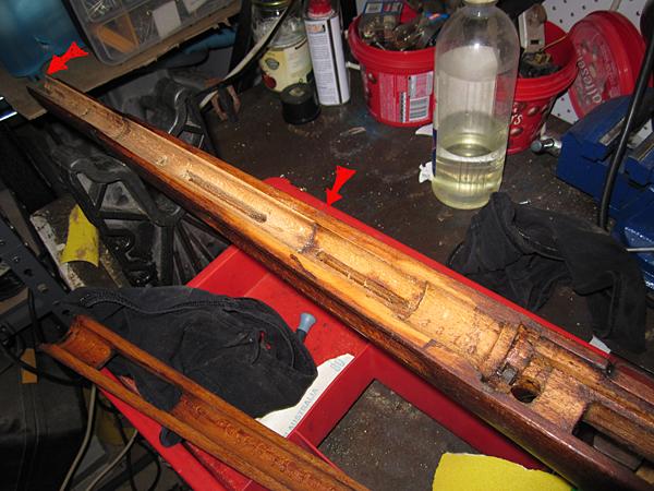

    Following on from my range report where I got a nice group but in the wrong spot I spent a little time looking at the stock of the M38. It is not the original stock and although the barrel was centered it was jammed up tight against the wood. Not even a thin piece of paper would go through.
    In the absence of the proper tools I got a texta and wrapped the sandpaper around it and started to relieve it a little. I kept on going until I could slide the paper through but no more as I figure if I get too excited it would look funny and it is a whole lot harder to put wood back than to remove it. You will see where I sanded from in the following picture. I only went back to the second step channel as I figured it would be of little consequence that far back. Note the amount of space I have to work in !
    Anyway, it is now just floating so it will be interesting to see if it has made any change to the point of impact. Back to the range next monday I spose !

    Quite correct so far!
    Quote Originally Posted by xa-coupe View Post
    I think you did the right thing. Hope it works! If it is improved, but still not quite right, then you may have to carry on back to the area with the second slot. But I would not touch the area where the number is stamped in the barrel channel.
    Looking forward to your range report
    Patrick

    Thanks Patrick. It will be a couple of weeks till I get back to the range however by then I should have the no1 Mk3 heavy barrel ready to roll as well. I think it will be a pretty interesting time from a lot of perspectives. I might even take my tools ( texta/sandpaper ) and do some on the fly changes if I need to. It was pretty hard up against the wood so I would think that I will get some change from this, just not sure how much.
