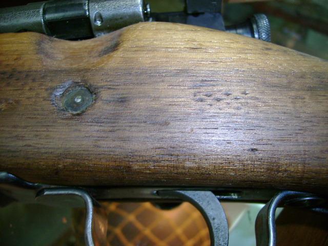

    Pvt Joker are there any remnants of any stock markings? left side behind trigger; in the cut off notch; forward of magazine or on the grip or wrist?

    Here's what I could find left on it. It almost looks like someone, at some time, had tried to checker it and then sanded that off. But the marks that are left are these:
