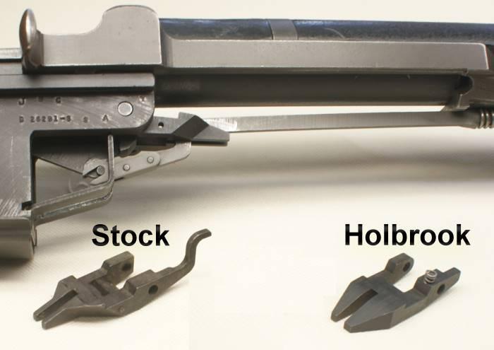

    by any chance does it havea holman device in it ?

    It does have a holbrook device in it. Why is that the case? Is this military or an add on after the fact?

    It's an aftermarket add on . It's purpose is to allow single rounds to be loaded for the long range slow fire course. It helps in this by allowing the clip to stay in the rifle and NOT eject on the last ( in this case , only ) round , giving you less to do ( worry about the ejecting clip , tracking it down , reinserting it into your rifle , etc.) . It is also used by a few reinactors or people doing a jungle course or any other reason where ejecting on the last shot may cause you to lose a clip and reloading time is not important.
    Just as an aside , I did hit the nail on the head as the device does have it's leg " broken " off. :>)
    Chris
