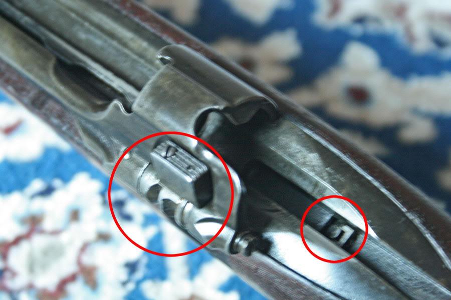

    I need some opinions on this 1903.
    It's a Springfield 1903 Pedersen device but I do not know very much about this variation of 1903.
    Serial nr.1125724, barrel date 11-19.

    Looks like a decent Mark I. Original stock, and looks like the original cut-off. How about the trigger/sear? Do you know anything about the stamping on the left side of the receiver? Is it an import?

    Pedersen Device parts:

    The magaziene cut-off and the sear assy in the picture are Pedersen Device items in the 1903 rifle. Normally seen today, they would be removed and replaced at overhaul time.
    The items will not prevent operation with the standard bolt in place for firing. Good items to have if they are replaced. There is a market for the parts.
