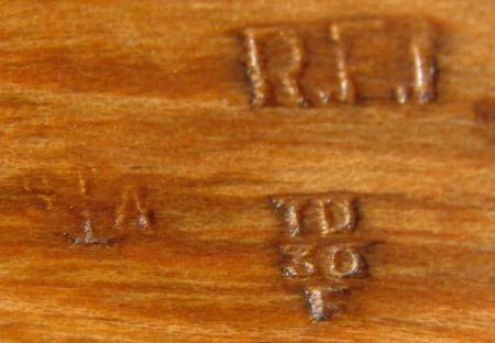

    Len Savage of Historic Arms had some grips done when he was building semi-auto BRENs. Perhaps he could be persuaded to name his source.
    An example is photoed in the auction below:
    http://www.gunbroker.com/Auction/Vie...Item=260945832
