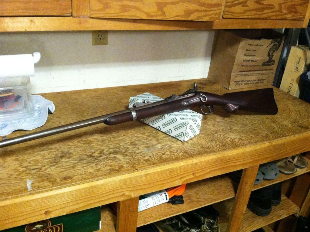

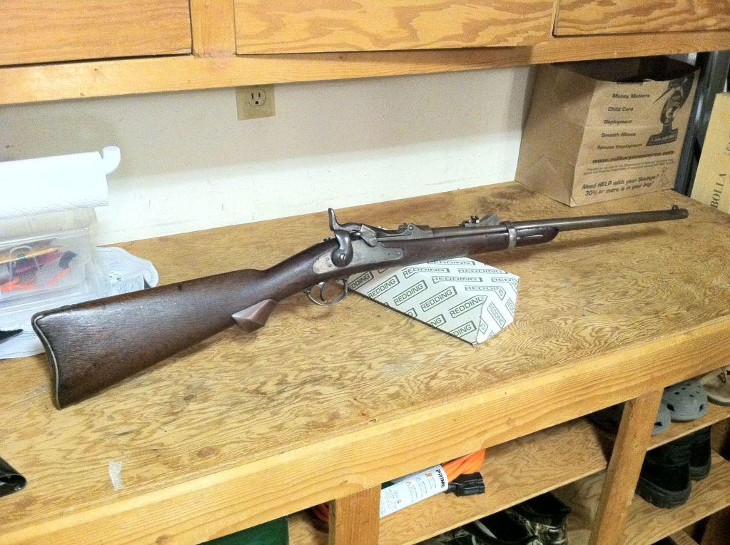

    I took a few photos of the new gun:

    It is my general understanding the 'starred serial number' denotes a weapon which utilized reclaimed parts from an earlier weapon and therefore denoted a 'second quality' arm suitable for issue to state militia, National Guard etc. My 'starred' Model 1879 Trapdoor rifle is also double eagle and 'VP' proofed on the barrel testifying to the fact it had been through a refurbishment sometime in its service career. A stock without a cartouche or P proof on wrist is almost certainly at best a field replacement stock. Some of the known field replacement stocks have been noted with a "X" or "R" stamped in the bottom of the wrist. The stock patina is really good on your gun and it has certainly been together a long time--don't think your carbine has been monkeyed about. Still, the fact the serial number falls into a non carbine manufacture block out of Springfield is worrisome-- could possibly point to a late 19th century Bannerman put together carbine built up from surplus parts. Can't say more without examining the carbine. Good luck.
