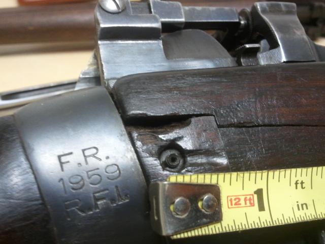

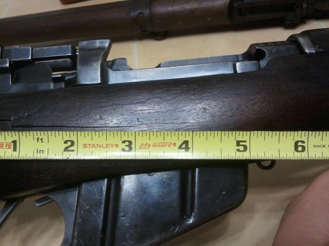

    I bought this Ishapore Lee Enfield No. 4 Mark 1/2 a couple months back. It has a 4 1/2" crack along the right side of the stock, starting right below the rear sight.
    Now, I know (at least I think I know) that this rifle is not worth as much as a Britishicon produced Enfield. Now, should I let the crack be? Or should I attempt to repair it? If so, what techniques or products should I use? Thank you so much, I look forward to any responses!

    If you intend on shooting it, then that crack should be dealt with beforehand. Either repair what you have or round up a spare. But even tha spare would likely require fitting, so it may not save you a whole lot of effort.

    If you're patient with wood work, then you can easily make a decent repair to that forend - it would be nice to leave the original forend on the rifle.
    The forend was converted from Mk1 to Mk2, which is why there is a block of wood surrounding the screw at the rear. Likely that this has shifted, or was never properly finished - hence causing a stress point that split the forend. You should be able to fashion a single block that not only replaces the crumbled on at the rear but that, internally, also provides new recoil faces. If you take the forend off and show us a photo of the inside, we'll be able to see the condition of the existing recoil faces.

    I think that the solution to stabilizing the horizontal cracking is glue and vertical running dowels or brass thread wire. Ensuring all the surfaces are thoroughly clean...etc and adequate accurate clamping blah blah..
    Then the rest of it, do you reglue or institute new rear blocks for the tie screw (don't know the real name)?? I'd have to look at it if it were mine, but I'd probably err with Thunderbox and go again, along with and integral patching of the draws, this could be pegged above and below the crack through the side to further stabilize the crack and integrate it all.
    I guess it depends a bit how good you are with wood work.
    If you're not up to all that, it could be easier to reglue the original setup and dowel/brass thread wire the crack.
