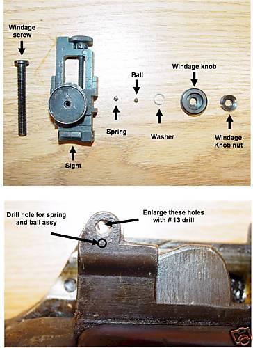

    On some sights sold as 'No4 target sights' there is a need to enlarge the holes in the 'ears' - is it possible it once had one of these sights fitted ?

    Those supposed windage adjustable No4 rear sights are NOT for the No4 but rather for a War office .22 training rifle. Enlarging the hole in the reciever is simply buggering an otherwise original rifle.
    The stamped No4 rear sight needs a small washer to hold it over to one side since it does not have the same base as the milled sight

    Good morning John. Good to hear from you again. The sight illustrated was a money saving idea for the UKicon Military L81 target rifle. Done on the cheap and using old existing parts where they could. The least said about the rifles, the better. It would have been better to supply the units that asked for them with standard L39's instead.
