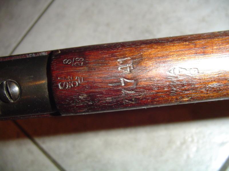

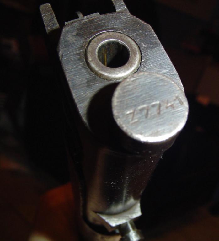

    Hi Guys, seem I never run short of strange questions.

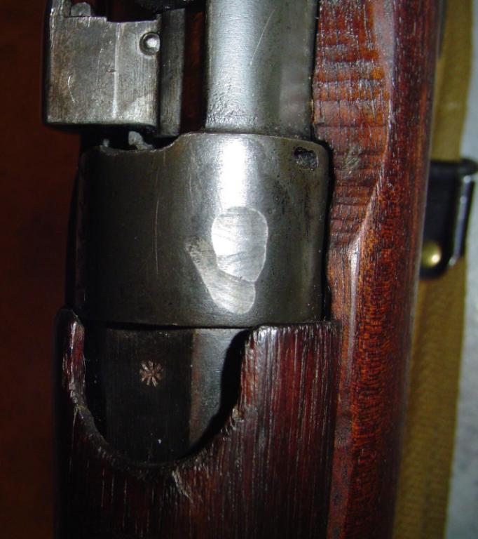

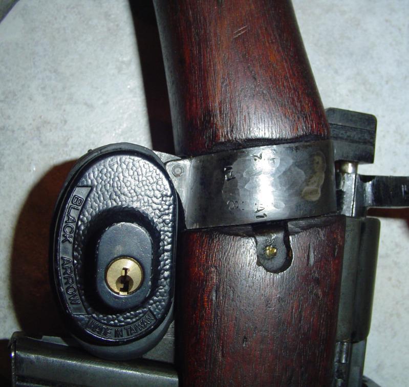

    What happened to this Indian 2A? Here are some pics sent to me be the owner of this 2A (or would it be a 2A1?). Why would its markings have been erased? And the star on the barrel knox?
    Thanks for any input,
    Lou

    The star would indicate corrosion or some drama in the chamber or bore. On these, it seems to also mean possible chrome plating issues in the chamber.
    The removed markings would seem to indicate that someone was trying to hide the rifle's origins. If the S/N is gone as well, that would likely mean "Stolen"! It may merely be a Bubba paranoia- sort of like removing "United Statesicon Property" from the frame of a 1911.

    Yeah, the star was what would make me worry the most.

    The star probably won't mean a thing in a practical sense. Mine all seem to be associated with some imperfection in the chrome lining in the chamber area. Most look like plating deposition dramas, and were there from the time the bore was new.
    The "scrubbed" areas don't seem typical of Indian linishing of old markings. It looks more like "Bubba".
