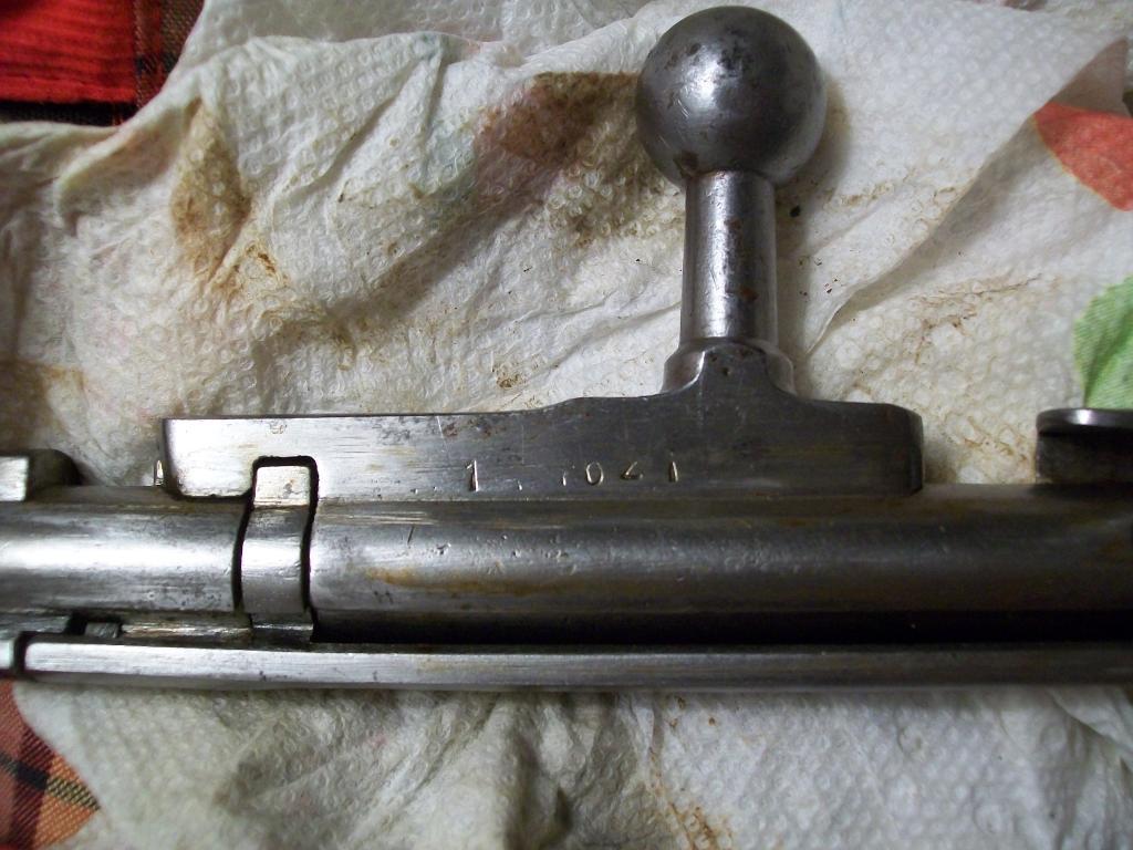

    Guys,
    As promised... here are extra photos of the bolt:
    Upside down photo of what appears to be the letters/ numbers: TK3x. Also seen is the bow and arrow (near bolt root).
    If you have suggestions on where to find any more cartouches... or anything of interest let me know.
    Ok... onto a photo of the stock.. inside the barrel channel....
    Now for some interesting photos... just to show the inspector marks... is there anything that I should look for?? As you can appreciate, the camera won't focus in that close...
    Moving to the rear tang and trigger region...
    Holy Smokes! There are certainly MANY marks and cartouches... any way to decode these things?? The tang does matchthe receiver ring (1897).
    Strange question... if you look at one of the photos, I have the following number on both the barrel and receiver (in line with each other): 531888. They are upside down! Why don't they match the receiver SN, and why are they below the wood (probably not importers marks).
    Thanks for viewing... and please make comments!
