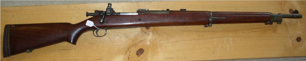

    Calfed, heres a few pics of the 1903/Unertl sniper clone:

    Crap, hit the wrong button. Heres a couple more.

    Vintage...a fine looking 1941. How does it shoot?
    Dec 2010
    S.C.
    57
    1,680
    05-06-2025
    07:22 AM
    Quite well actually, but it has a fair amount of throat erosion so I don't shoot it much. Mostly during deer season. It has a particular fondness for handloads using 180gr Nosler Ballistic Tips and IMR 4064 powder at 2600 fps. ATM, my range is limited to 300yds and it stays sub MOA that far, will be interesting to see how it does at longer distances. Got yours up and running yet?

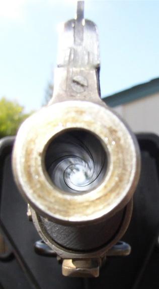

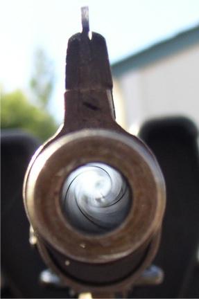

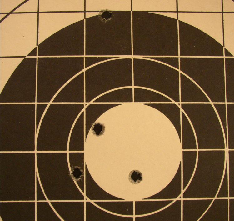

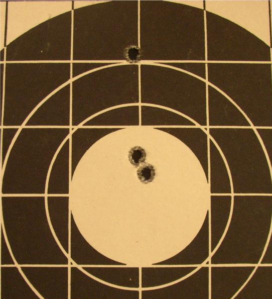

    I got to the range last week and fired a few Federal Powr-Shok 180 grainers through it. I didn't want to waste much ammo, because I had to use the threaded hole that the aperture screws into as the rear "aperture". I tried to use a couple of my other apertures and they either wouldn't screw in far enough or were too large to operate the bolt with.
    Fired a few @ 50 yards to make sure the windage on the sights was good...
    Moved the target back to 100 and got this...
    Without an aperture this was more of a Ghost ring sight than a target sight. I'm pretty sure that the flyers that went high were my fault. I usually do fine with the windage using aperture sights, but have some trouble reproducing the elevation aim from shot to shot. I'm pretty sure this will do better. The barrel is a Sedgely in great shape
    I got an aperture from Apertures and More and hope to get to the range again in the near future.
