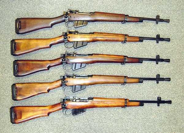

    I don't have these particular rifles any longer, but 2 and 4 were 1947 Fazakerleys in brand-new condition, and both had M47C-marked flash hiders. It seems to be that the BSA parts do occur on the late Faz rifles.
    Number 5 was a 1946 Fazakerely with all-Faz marks. Number 3 is a BSA - as you can tell by the colour!
    (Interestingly, number 1 and 2 were only a couple of hundred numbers apart, but number 1 had seen a bit of service. Interesting how the rifle had physically changed colour, even though it had not been restocked)
