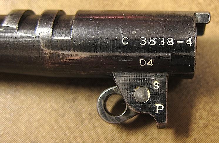

    During the production of the Model 1911A1 pistol no drawing numbers at all were used on any of the parts even though there were five manufacturers. The only part I am aware of that was ever marked with the drawing number was a replacement barrel, and it was manufactured by Springfield Armory.
