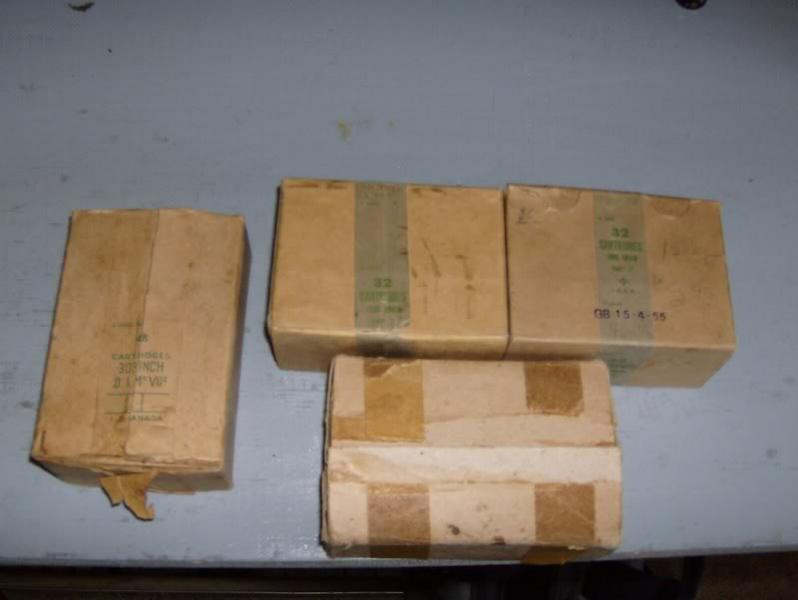

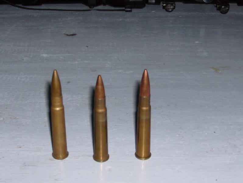

    Well brewster, here is a pick of what the ammo looks like, on the whole the brass is pretty clean. I have one box in bad shape and two others that a in very good shape i think i could be wrong. the ammo headstamp says di z 1944

    The DI stamped stuff is "Defence Industries" and it's Canadianicon. Good ammo, but corrosive.
    I can't make out hte labels too well on the other stuff, but it looks vaguely Indian in origin. Won't hurt to shoot it, but the quality may be lower.
