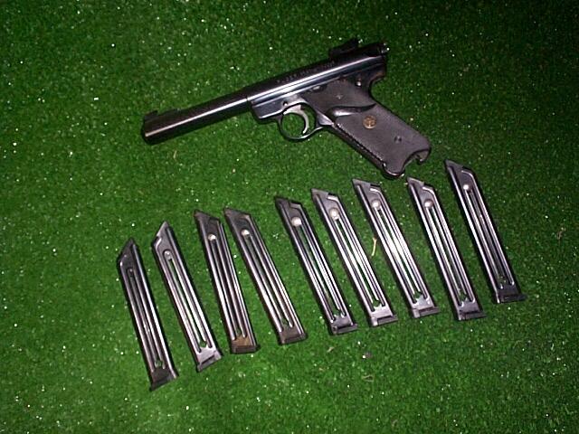

    don't make things overcomplicated!
    1. make sure the hammer is released (i.e. pull the trigger) so that the hammer strut (the dingle dangle thing) is down inside the grip channel and LOOSE. you can see it easily.
    2. push UP VERY (VERY) HARD on the mainspring bolt-stop housing PIN to make DANG SURE it is FULLY up into the receiver tube hole.
    3. hold the pistol like you are shooting at a squirrel high up in pine tree. SEE THE DINGLE DANGLE (hammer strut).
    4. CLOSE the mainspring housing latch.
    It will NEVER close unless you have BOTH the mainspring housing pin fully seated and the hammer strut dangling down at the right angle.
    here is a good video (if you need it).
