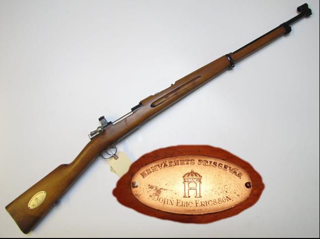

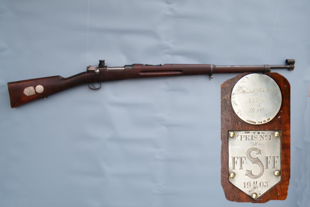

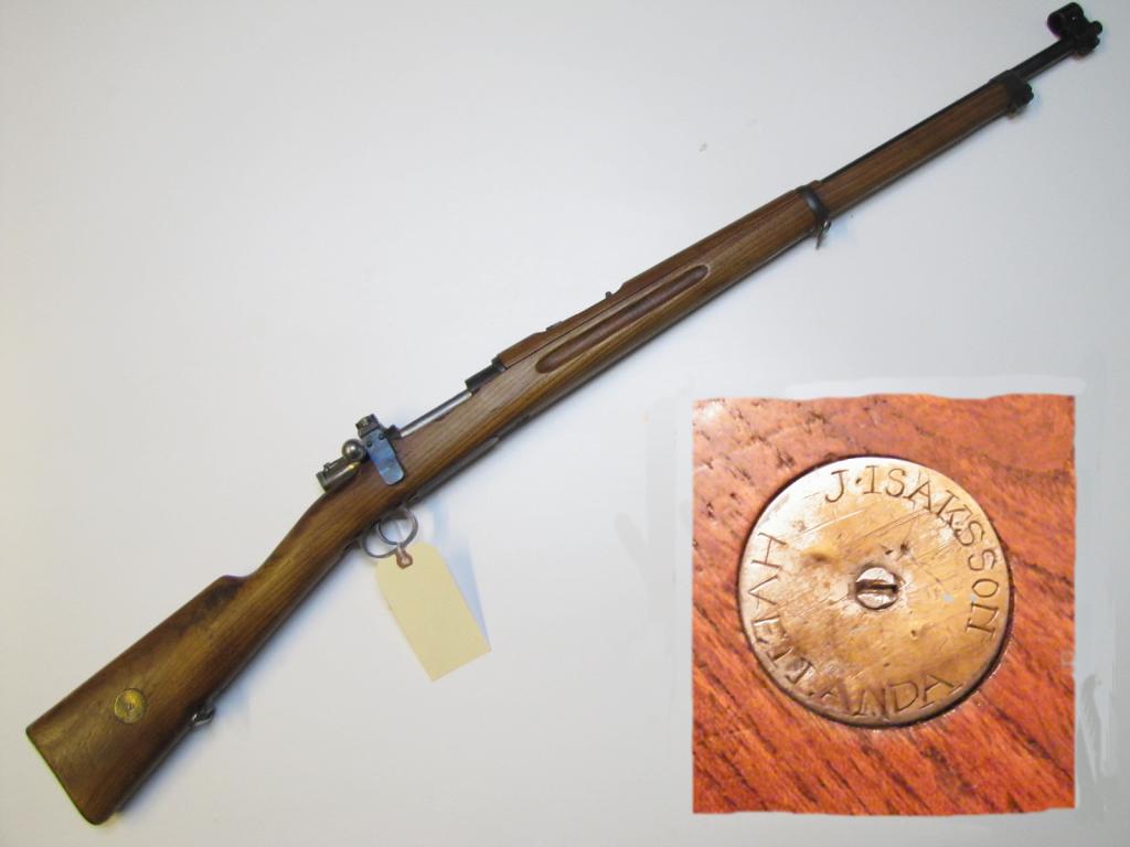

    I am not surprised that your m/96 that has no stock disk or range plate shoots really well. It was probably a civilian or club owned m/96 (FSR) target rifle. Civilian shooters were allowed to buy their own m/96 Military target rifles for competition use. The stock disks and range plates were generally removed from these rifles as the disks are more for information for Military Armourers than Civilian use.
    Sometimes a shooter would fill in the stock disk hole with wax, a piece of waterproofed paper, a silver disk or cover it with a plaque. These plaques or disks most of the time had the owners or club name on it. Also, some rifles were given out as prize rifles, and these usually had silver plaques on them that denoted the Donor's name and date/event. The Winner's name was usually inscribed on the plaque later.
    Generally a FSR rifle was better taken care of than a Military one, because it was personal property of someone or some club. Also, these rifles tended to be a bit more accurate than a regular rifle, as no shooter of any worth will keep a problem or inaccurate rifle very long. The prize rifles were a bit better quality with regards to figured stocks and finish, because no one wants to be known for giving out a crappy prize. The Swedes took pride in their shooting.
    Here are a couple of examples of Prize Rifles and a rare 1916 Elm stocked m/96 with an owners name disk.
