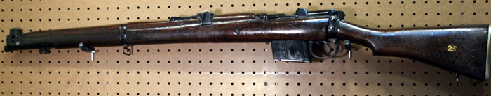

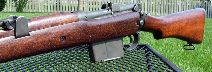

    More questions, is this restoration?
    More questions, is this restoration or refinishing?
    Before
    After
    After looks nicer, but does the removal of the stock numbers diminish it's historical value? Could you clean the rifle as in "after" photo and repaint the stock number?

    Tough question. If the rifle ends up with a different finish than it originally had, I'd say it was "refinishing". Kind of like doing a BLOicon finish on a M91/30, it's just not correct.
    If it keeps the original finish, restoration.
    Personally, I'd avoid removing any stock markings if at all possible in either scenario.
    Whether you want it as a collector or shooter should also influence your decision.

    Quote Originally Posted by Oatmeal Savage View Post
    Yes, removing the numbers diminishes value. Repainting the numbers would be worse....much worse.
    Would you want a collectors piece that someone had painted numbers on to make it look original? (other than the original people?)

    From the photo, that rifle needed a cleaning. What was done wasn't restoration.

    That rifleonly needed a stock wash and metal degreasing. I got more than was needed - far more. All original 2A1'sI've seen had painted numbers on the butt. One without them would scream "refinish" to me
