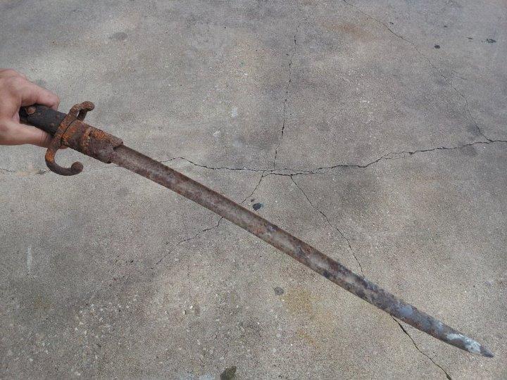

    Nice! I found one this morning in my storage shed on the property im renting!
    Mine's in horrible condition, but its still awesome to know what it is, how old it is, and where it came from!
