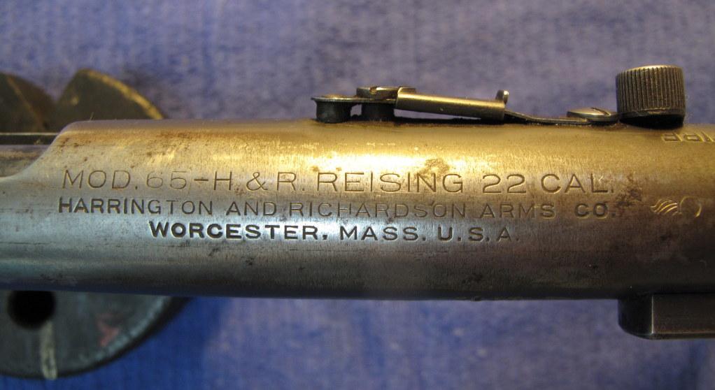

    I purchased an H&R M65 that some of you may have seen in a recent auction. This rifle has some markings I have not seen on this model before. Any rifle that has been around for almost 70yrs will collect unusual markings and alterations. We often see rifles tapped for a scope branded as "Sniper", Redfield sights make a "National Match" or threaded barrels create the top secret gun designed to kill Hitler. Often the same rifle is discussed on several Forums giving the impression that there are many guns with a particular curiosity.
    So I am a skeptic. Are these original Ordnance markings? Let me know your thoughts.
    My M65 has a worn light gray Parkerized finish, receiver has the usual markings plus a Flaming Bomb stamp.

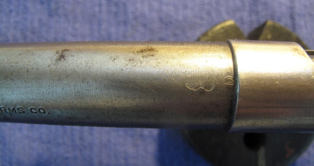

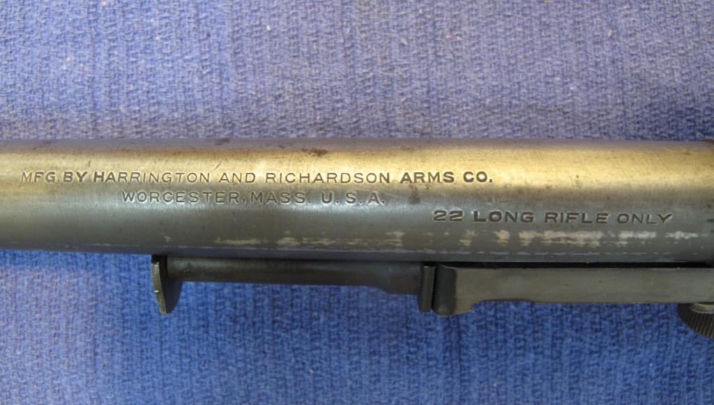

    Typical markings on the barrel plus Flaming Bomb

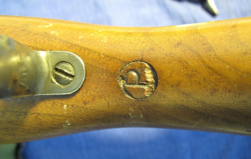

    A "P" behind the trigger guard.

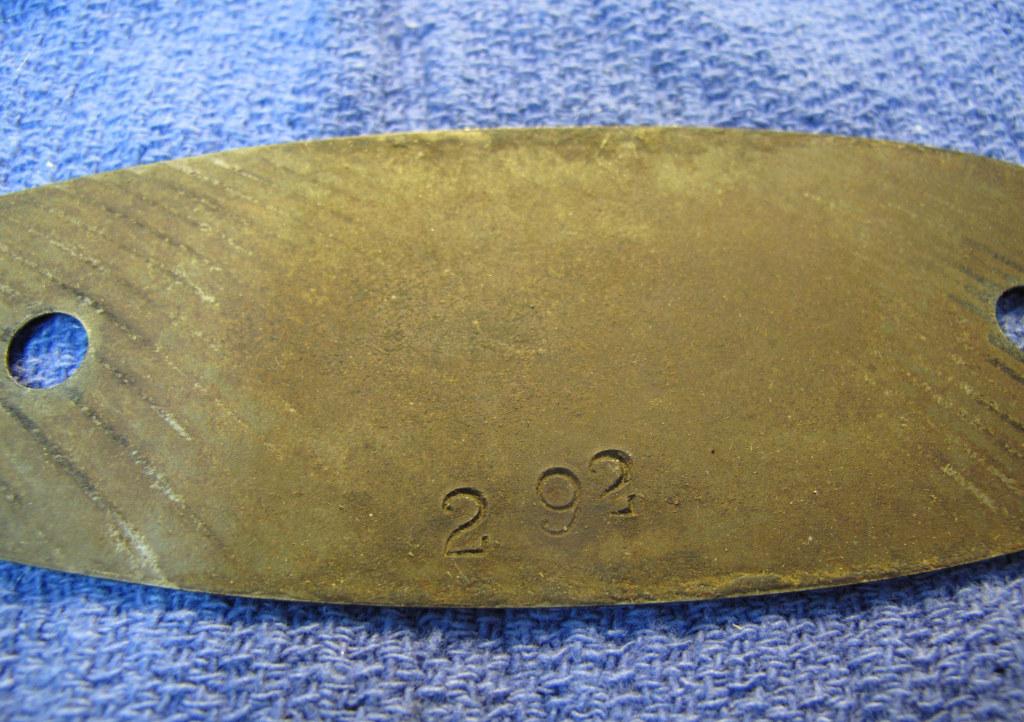

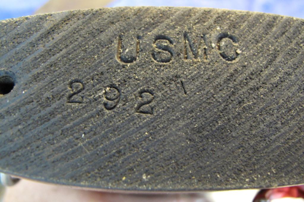

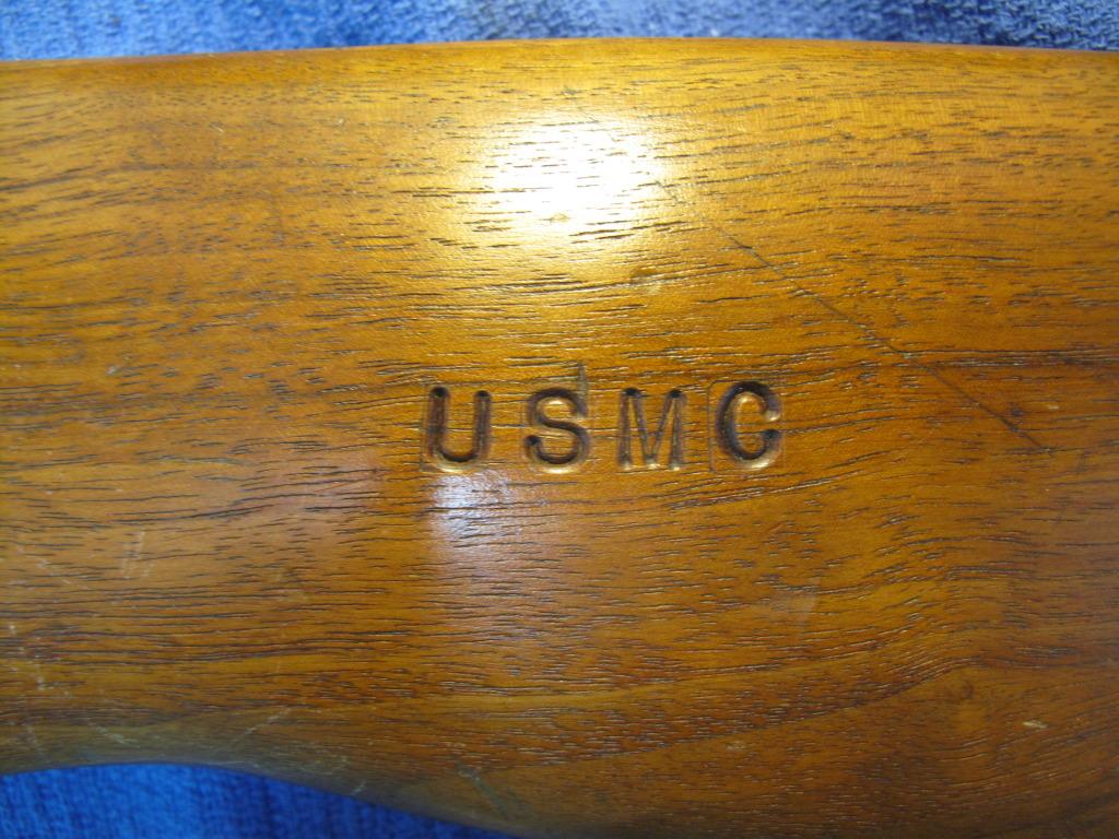

    USMC is stamped on the side of the stock and under the butt plate. An assembly number is found on the butt and plate.

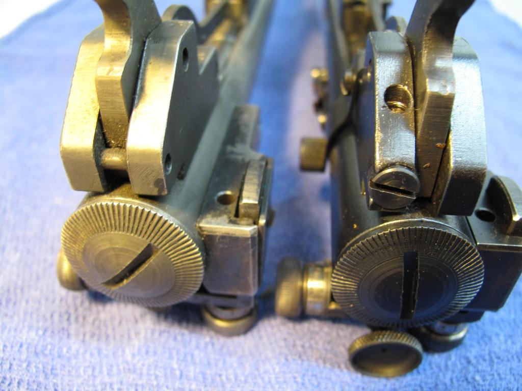

    Finally, a comparison of the M65 / civilian M165 trigger assemblies.

    Military Reisings do not have flaming bombs , circled Ps , nor USMC stampings . These are all added fakes . Please don't tell us that the serial number is below 5,000 or so.

    Thanks for the info. I suspected the markings were added to the rifle by a later owner. Seller told me he purchased the rifle from a Quantico Marine armorer. I don't think an amorer would apply these stamps at that level.
    I hope it shoots well.
    Serial number 51XX.

    USMC marking
    Interesting... My H&R65 came to me from a WWII Marine vet who was on Guadalcanal and then thru the islands. A demolition man, he re enlisted after the war for another hitch.
    Mine has USMC stamped right above the SN (46XX). Both serial and USMC look similar in age
    I.E. the USMC does not appear bright inside the stamping. He said he brought it home after he got out.

    By any chance is your front sight lacking the protective wings ? Is there exposed threads on the barrel forward of the front sight ? If no threads are visable , is there a light knurling between the front sight and the muzzle ?
    There are no records of the "USMC" being applied by the factory. If so , they would hae been a roll stamp or a single stamp. Look at how the letters align and see if they were one or four separate strikes . See how in the above pics the letters are way misaligned in one pic and fairly aligned in the other ( but there you can see the boxes from the individual stamp dies ) .
