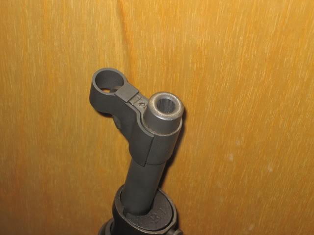

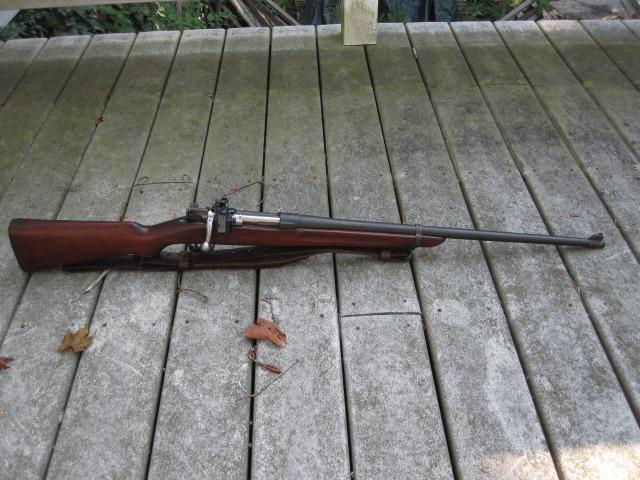

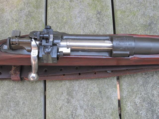

    I disassembled the rife completely (except the barrel/receiver) and gave it a good cleaning then a slathering of Ballistol. She look pretty good... with a few 'character' marks....
    Now that it's clean it appears as though the receiver finish is original.

    When the 1922 Series Springfields left SA as new items the bolt well (round channel the bolt moves in) was in the white. When they were refinished the bolt well would be left parkerized like the exterior of the receiver. That is a nice looking rifle. The elevation/windage slide on the rear sight has "hunter" type knobs. The 48C that came on the rifle had knurled knobs for adjustment without a coin or tool.

    Thank you. The bolt well is in the white. The sight is a 48S. I may shop around for the correct sight. Overall I'm very happy with the rifle. Once I rebuild my cnc mill I may make a front sight hood for it as I did for my 1903 with Bill Benz USMC sights.
