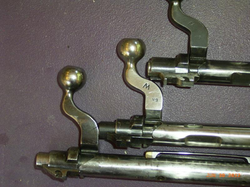

    Some one wanted to see a modified bolt (cock-on-opening conversion) vs unmodified.
    Top bolt is a Winchester, unmodified. It may be hard to see the bolt cocking cam.
    Center Bolt is a Winchester modified. Note the difference in the cocking piece and the bolt cocking cam as compared to the unmodified Winchester bolt -top
    Bottom bolt is Remington M30S converted by Remington to cock on opening and sold commercially. Note longer firing pin fall.
    On the non commercial modified bolt, the firing pin fall may be very short and cause misfires.
