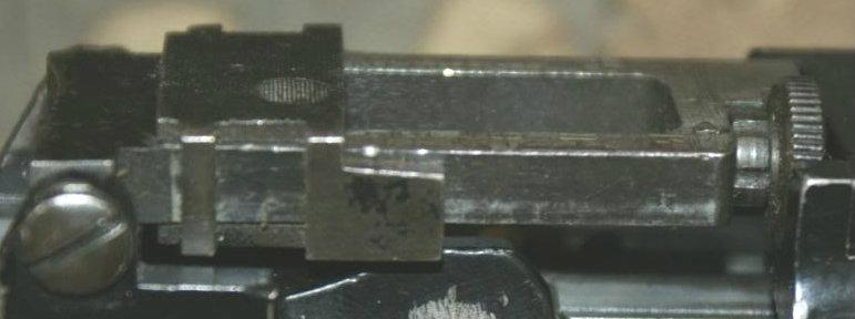

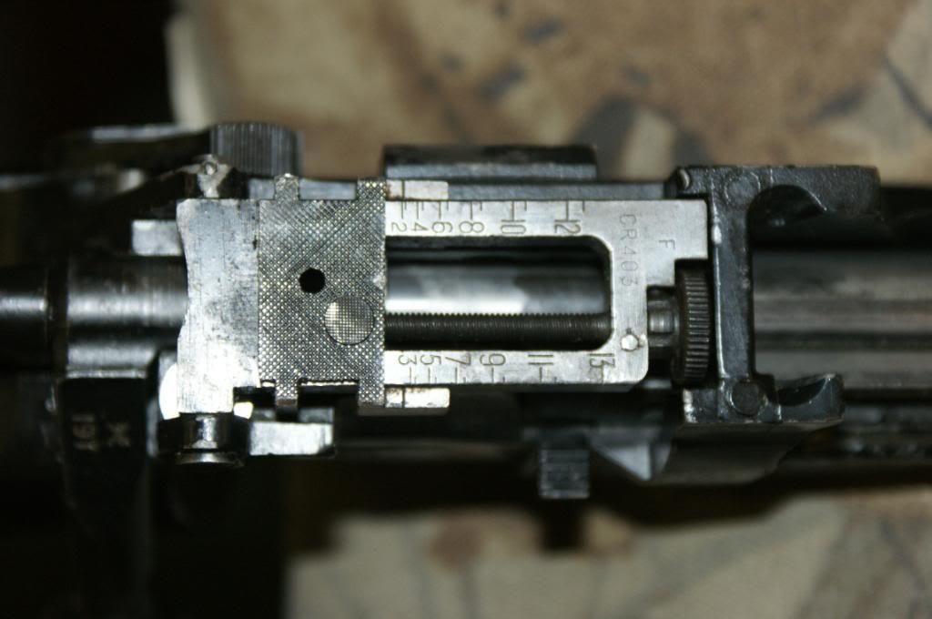

    jmoore's Avatar
    06-09-2023 @ 04:20 AM
    US of A
    7,066
    05-10-2025
    06:21 PM
    Well, it shows the relocated index mark at any rate.
    Oh, here's another:
