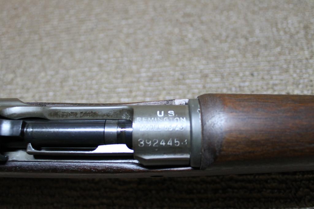

    I picked up a Remington 03A3 and would like to know if its 100% original.

    Smith-Corona bolt? Looks that way. Heavily sanded stock. No other comments.

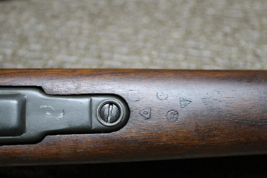

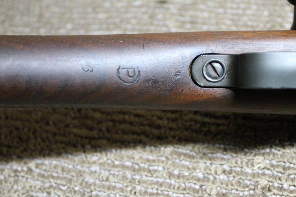

    It's been through the San Antonio Arsenal ( SAA-A cartouche and P firing proof in a square) and has had at least a check and test. Bolt is from one of the contractors that produced parts for the 03/03-A3's, so is not a Remington. In my experience, very few came out with the same parts that they went in there with.

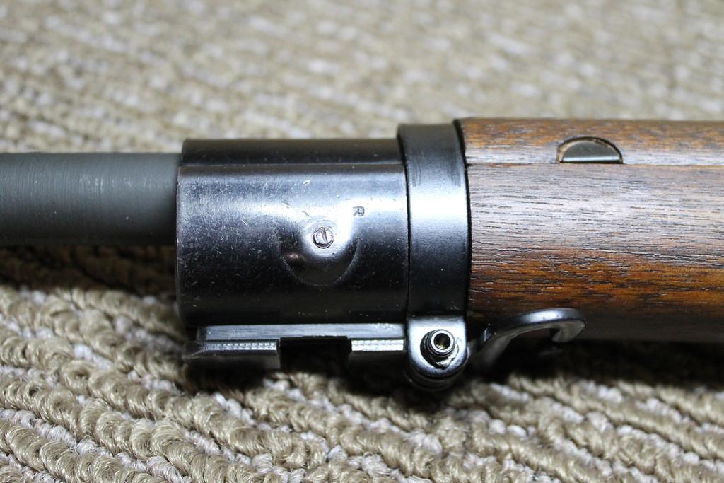

    I have an A3 that is very close to yours as far as production date and also has a 9-43 dated barrel:
    This is what the stamps on a Remington stock look like. The cartouches on the side are faint, because at some point someone felt the need to sand it. This stock went through the check and test program at the Rock Island Armory (faint RIA in a box in front of the cutoff). Stamped behind the stock bolt are, in order; RA, crossed cannon ordnance stamp and FJA in a square box. All the parts on it are Remington.
    Inspectors stamps.
    Firing proof
    Remington marked bolt
    Bayonet lug.
    While yours may not be 100% original, it still looks like a nice rifle. If the small parts that don't match bother you, they can be replaced with the correct Remington marked ones.
    I would leave it alone as it has it's own history.

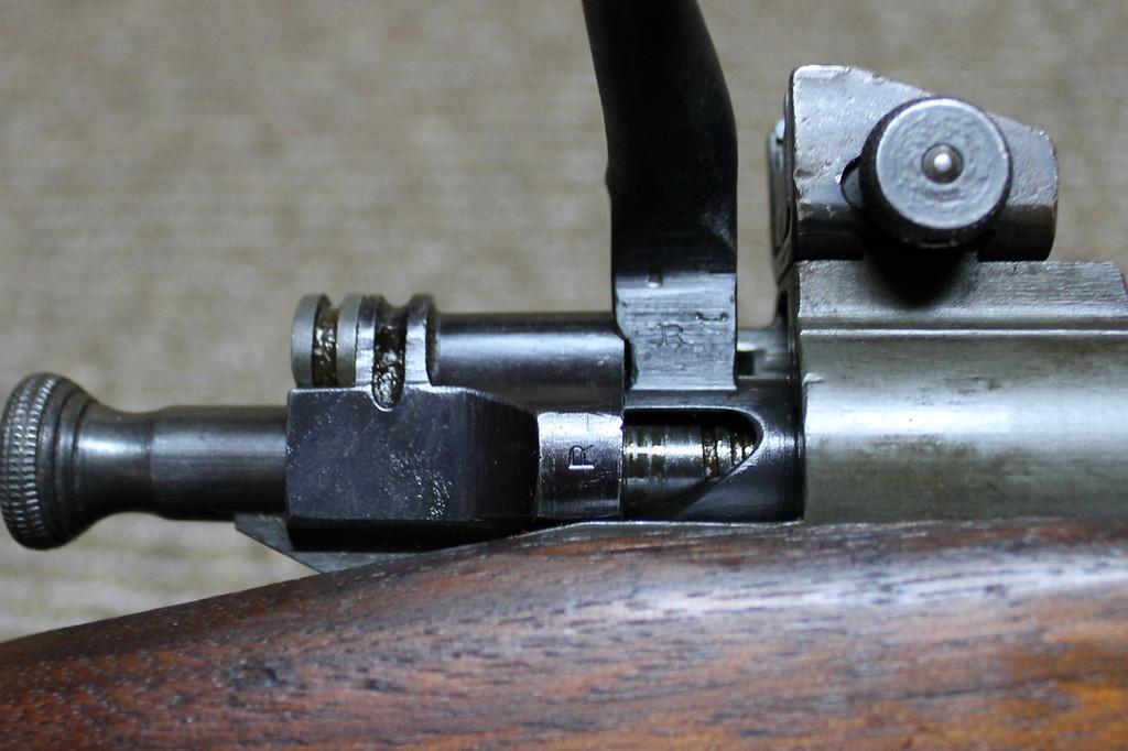

    Attachment 39584Attachment 39583How can I tell if the bolt is from a different rifle? it does have the letter "R" in the same place as the other pictured. Also what would I need to change to make it "correct"? Are there any other items other than the stock that are in need of changing? I appreciate any help I can get. Thanks
    ---------- Post added at 05:50 PM ---------- Previous post was at 05:44 PM ----------
    I compared my rifle with the other pictured and the letter "R" is in all the same places. The only differences I can see are the stock and the number 8 on the bolt handle. I am just learning about the 03 so all the help and opinions are appreciated.

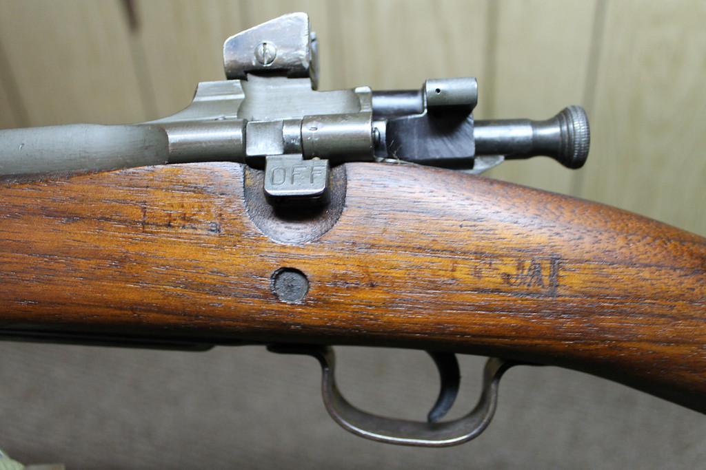

    This is my Other Springfield. If it had not been drilled and tapped I would consider trying to have it put back to the way it was originally.Attachment 39586Attachment 39585
    Nov 2011
    Yesterday @ 11:03 PM
    792
    05-05-2025
    06:44 AM
    308-- Wow! Has the barrel on the sporter been cut? The rifle looks like a great candidate for an 03a4 clone. It is already drilled and tapped and has the Redfield mount. If the barrel hasn't been shortened it would make a great sniper project. Salt Flat

    I don't think the barrel has been cut. There are dimples on the end where the front sight was. It has been polished and the date is no longer there. It has a 2 groove barrel. I had thought about a sniper clone but have not had time to check in to it. I bought it a few months ago for $200 and it shoots good. I would like to know more about the 03 rifles but I have not had time to do any reading. Is there a good book about the Springfield 03 rifles?

    The bolt body is a Rem, but I don't think original. It seems those ones marked with an "8" or "3" on top are sub-contract bolts, but I'm likely wrong.
    The finish on the bolt and receiver are not original. Don't know if the flash mucked it up or what, but it looks like some cold blue may be involved.
