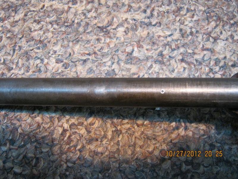

    Here is a pic of the barrel. I also have lots of pics of the carbine on the CMPicon forum about this carbine . Trying to get some info on it. It has a M3 prototype stock ?? but also has some work done on the stock & receiver . under M1icon carbine stock fake or ariginal ???
    [IMG]img_1812[/IMG]

    I had the opportunity to thoroughly inspect NPM # 4230716 that a friend's father brought back from the ETO in Q3 of 1945. It has an undated IBM barrel I believe to be original to the receiver. I would think this carbine dates to Feb/Mar of 1944. HTH

    4232144 various 4234279 used in the 5th interchangability test March 6-11, 1944
    The IBM barrels were used in the last batches. I have 4259700- IBM barrel

    February 1944 for your serial number. The information on a Dutch conversion may be correct.
