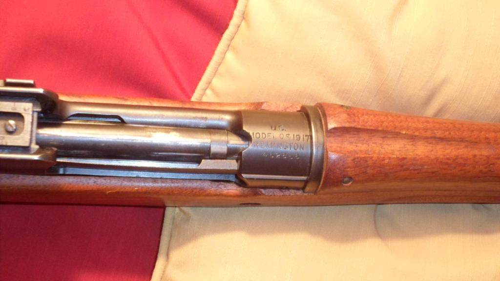

    Hi all,
    I could use some of your collective expertise again.

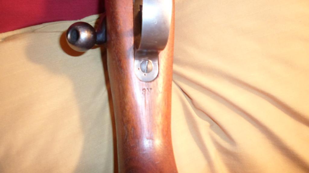

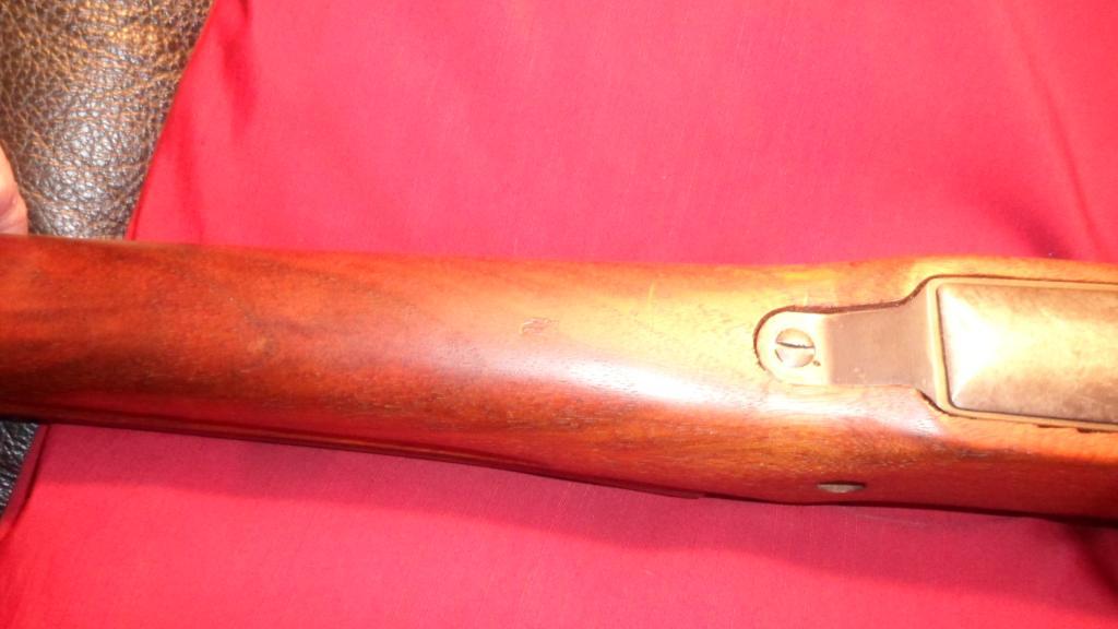

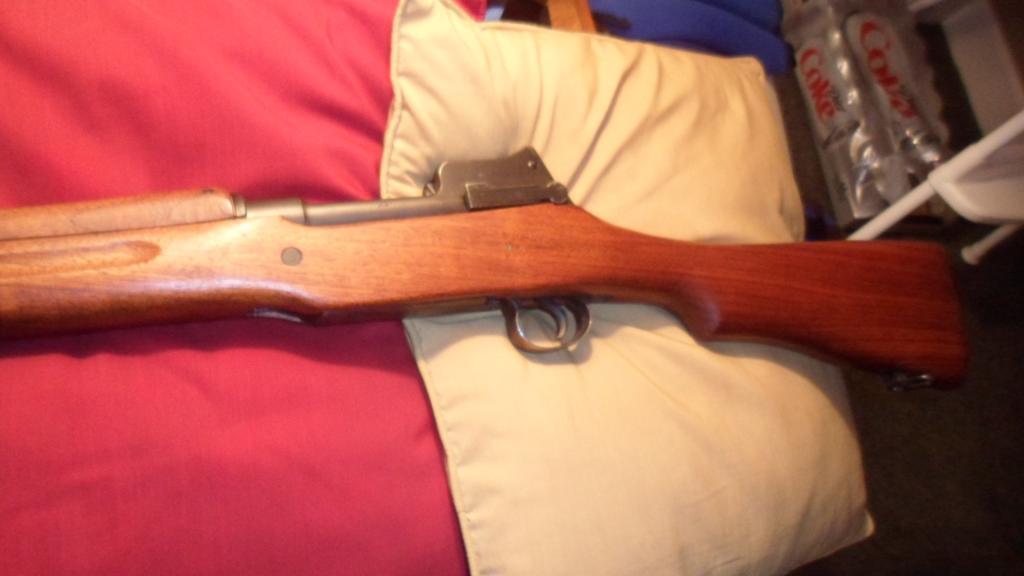

    My buddy has me looking at his Remington 1917. I'm considering buying it from him. There is an odd notch on top of the receiver next to the serial number stamping that I have not seen on any other rifles of this model. It looks like one half of a hole has been milled, but its not totally concentric. It flairs at the edges, so the diameter is more than double what the radius (measured perpendicularly) would measure. Make sense? Regardless of the shape of the hole, why is it there? Also, the stock is freakin' gorgeous, obviously not original, yet it has an eagle stamp in front of the trigger guard and an the alpha numeric "3N" behind the trigger guard. There is no arsenal rebuild cartouche anywhere on it. There is a very slight E stamped on the fore-end which should correspond to an original Eddystone stock. Could the stock be a replacement meant to look like an original? The rest of the parts (without dis assembly) are mostly Remington, govt. eagle inspection stamps abound in the normal places. Would love to own it, but don't want to pay collector pricing for a mix master. Thanks for any info and opinions that you wish to contribute! Mark.

    common on Danishicon lend lease, and Canadaicon lend lease, it was to show at a look that the rifle was a 30-06. and not 8mm or 303.

    This was done by the Norwegianicon Army to allow the usage of a special stripper clip. Since the Norwegian sold this rifles to Denmarkicon in 1959, it might have once been in Danish property aswell.

    Do you have one to show us? Or can you explain what the difference is. It's a bit hard for me to imagine, unless they resemble a Nagant clip...

    I thought someone said the notch had something to do with a .22 adapter.

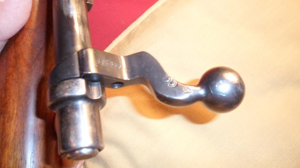

    The stock isn't a later replacement, it's just from the Remington Eddystone facility. Not an uncommon situation. The stocks weren't numbered to the rifles. 95 years. And was in service in various countries about half of that. If the bore is good call it "loverly" and see how it shoots. Note that the bolt wasn't serial numbered at the factory. But it's a perfectly legitimate "in service" Canadianicon marking, so no worries there.

    being in the U.S. most likely this is a Canadaicon or Danishicon re import, and will likely have the import marking on the barrel as well, serial numbered bolt , notched ring, ect are all tell tail signs of this,
    have yet to see a Norwayicon lend lease 17 in the states yet, if i saw it,,,id own it, or at least try my best to do so.
    iv owned a few of these over the years, most are nice, well kept rifles. and shoot exellent.

    All U.S. M1917 rifles made at Eddystone, PA were made by Midvale Steel and Ordnance Co. Midvale had been, along with Baldwin Locomotive, Remington Ilion, and many others, a partner in Remington Arms of Delaware, a Delaware corporation, separate from Remington Arms- UMC. Remington Arms of Delaware made the Britishicon Patt. '14 rifles at Eddystone (marked ERA, Eddystone Rifle Armory). No major exchange of components took place between the three manufacturers of M1917 rifles. Stocks were changed over the years for many reasons, by many people, and it is impossible to state how or where a given stock was assembled to a given rifle.
