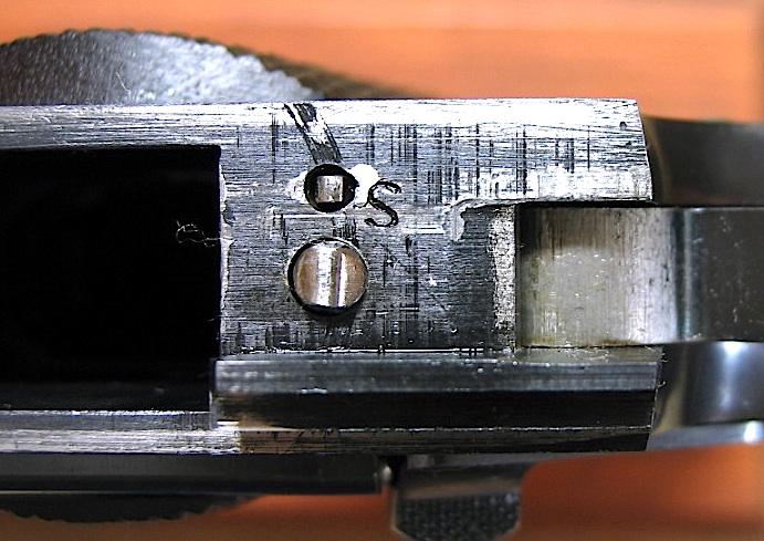

    Swartz safety? Not totally sure what one is. I compared my 1943 with my new Auto Ordinance and looking at the under side of the rear of the slide the new one has a hole with a post inset and the 43 does not. is that the Swartz and are they on new ones as required by law or??

    This is the Swartz Safety as found on the pre WWII Colt Government Model. I don't believe there is any law requiring any additional safety.

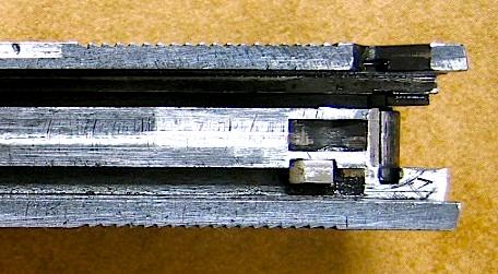

    Funnily enough, the Swartz safety may now be found on Kimber 1911 variants.
    The Colt pistols which still offer a firing pin safety seem stuck on their '80 Series safety which most folk don't like as well.

    The original Colt Swartz safety worked off the grip safety where the Colt 80 Series works off the trigger. The extra duty given the trigger didn't help the trigger pull.
