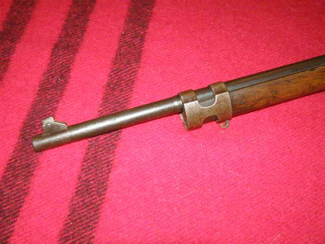

    Turkish M1903 shaft
    Albayo, we need a clear photo to replace the fuzzy photo (the 10th one) in your post of 14 Nov. It seems to show a hole in the wood for a cross-pin to hold the bayonet lug portion. But the Gew98/Kar98 style of bayonet lug has a boss that fits into a hole in the fore-end, between the barrel and the hole for the clearing rod. I cannot see this hole. It may have existed and since been plugged, but I cannot tell from the fuzzy photo. The lack of hole for a boss and the gap between the front band and the wood suggests that the bayonet fitting on this shaft did not have a boss behind the plate, but a piece of metal sheet shaped to fit the curve of the wood. But this would not have been a standard German 98 - G or K. The answer seems to be that the original fitting was somewhat closer to the wood, and fitted the recessed portion which is clearly smaller that the Gew/K98icon style of barrel band.
    I therefore begin to suspect that the shaft is not original to the rifle, but a replacement. The disk proves nothing - it could have come from the original shaft or some completely different rifle. Add in the buttplate, and I think this rifle has been made up from whatever was available for whoever did the work. The Turkishicon M1903 did not have a bayonet lug in front and boss fitted into the wood behind, but a simple front band with a bayonet lug below, for older style Turkish bayonets (from the 1893 model?).
    So I agree with m4a3sherman, and will even be more specific - it looks like a Gew98 barreled system fitted into a Turkish M1903 shaft.

    Thats interesting Mr Chadwick and m4a3sherman it could have spent some time in Turkey. There is a hole in the forestock where the bayonet lug should fit. I will take more pictures of that part of the gun. The barrel bands match the serial number so it must be missing the lug.
    Will there be a serial number of the gun in the barrel channel? I have three of the Gew 98's, and 2 or 3 Turkishicon 1903 Mausers in my collection so I can compare them. One of the Gew 98s I have came through Turkey and had a message under the hand guard when I took it apart to clean it. I put it on one site and someone transelated the message, but I can't find the transelation. I appreciate you gentlemen taking the time to help me with this Mauser.
    If anyone has a bayonet lug for it I would appreciate your help.
    I tried to fit a K98icon bayonet lug to the gun but they are different. This one requires a larger openig to accommodate the wood. Its hard to explain so I will take a picture of a bayonet lug comparing the wood and the lug from a later K98.

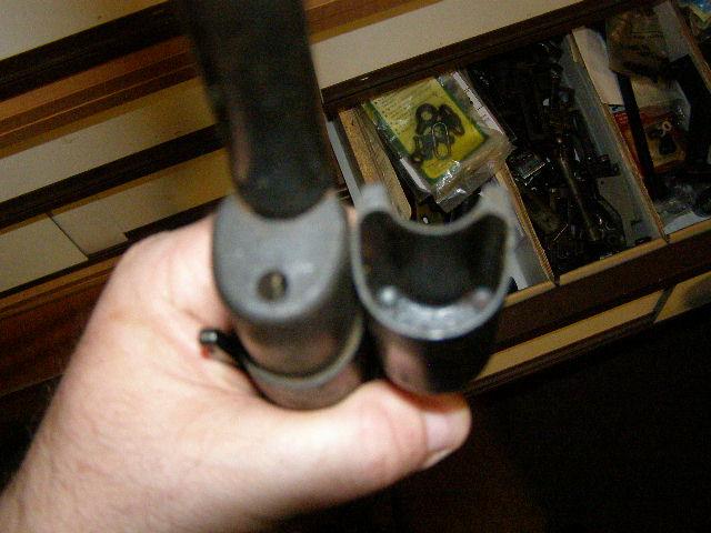

    I just compled taking the gun apart and its the original the stock and hand guard.
    I took some more pictures of the stock and proof marks on the barrel and action.
    What I really need is the proper bayonet lug for the old Gew 98. As you can see the difference in the stocks and the example of the bayonet lug. I could alter the wood to take the newer lug but I prefer to keep it as it was first manufactured.
