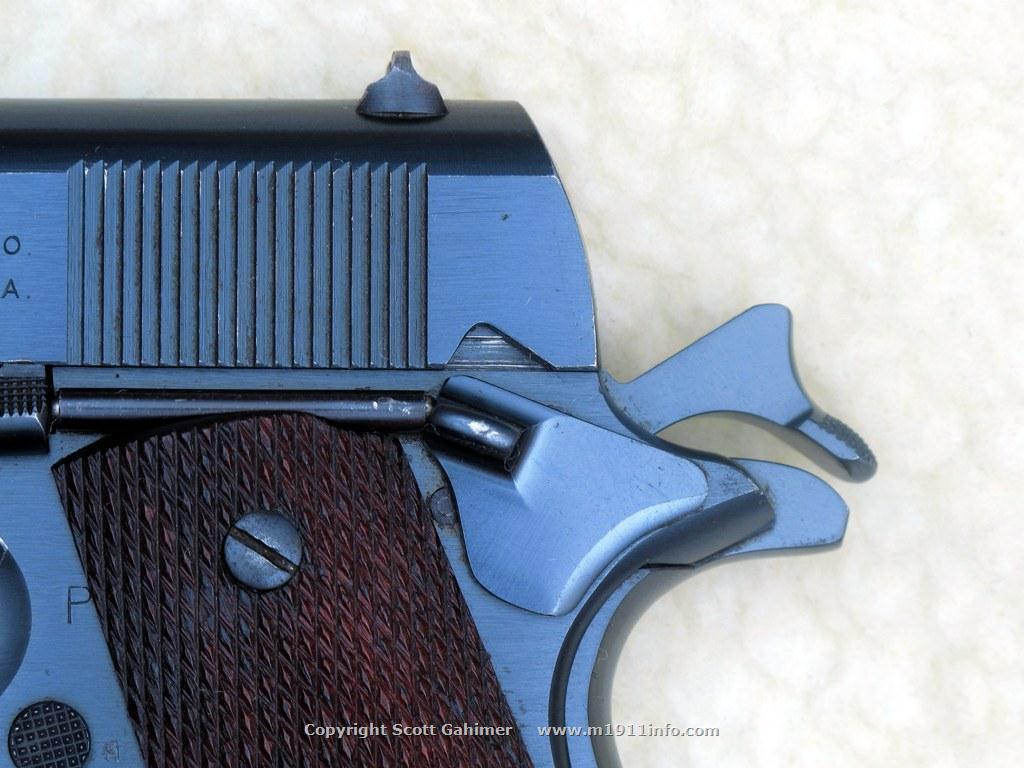

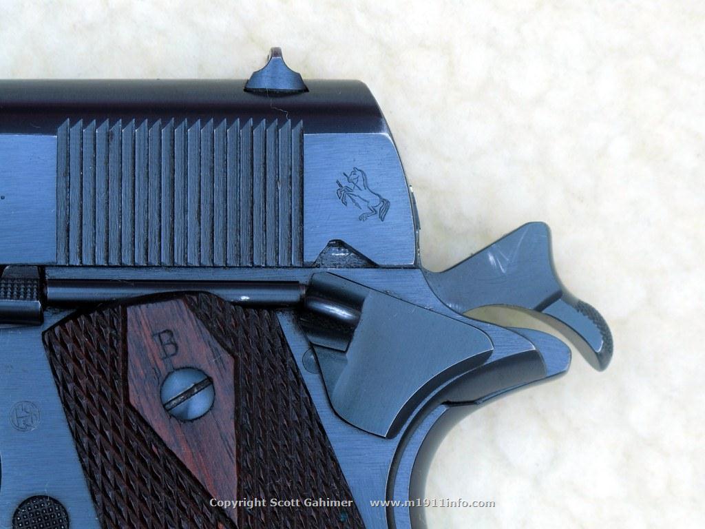

    A friend asked for some photos of hammers regarding the subject of hammer bite. So I shot some images of the different Colt hammers. It'll take a couple posts to show the 15 images.
    Colt's first variation M1911 hammer
    Colt's 2nd style hammer; long with sharp back edge
    Colt's 3rd and final style M1911 hammer; long with rounded edge
    I'll show the M1911A1 hammers and grip safety next post.
