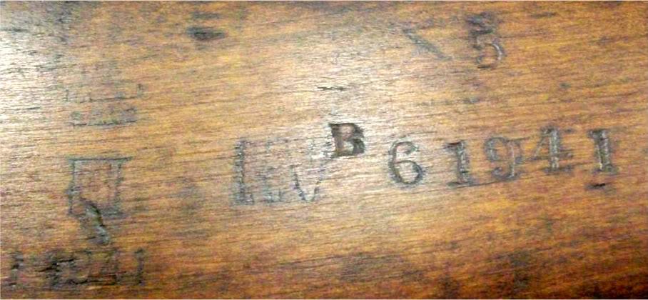

    Here are some pictures.

    No forum expert here but my guess is that it is a re-allocated serial number, or in other words a replacement action for an earlier rifle sometime between 1944 and 1951 when it was FTR'd but probably some time closer to the action date. Either that or they forgot to stamp a letter prefix E when it was made. Both suggestions probably very unlikely possibilities in the minds of some but I've got nothing else. It looks like a very legitimate rifle to me.

    What are the markings on the wrist (right side) under the bolt handle that should tell you its story as it is it was FTR in 1951 at Lithgowicon so no letter prefix, was probably sent from Lithgow to War Stocks hence just the * on teh butt disc.
