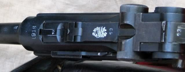

    Just got a 1918 New Model luger and I am trying to learn as much as possible. The only thing I have not figured out is the numbers of 8.84 undeneath the barrel. Can't be a caliber.
    Any ideas?

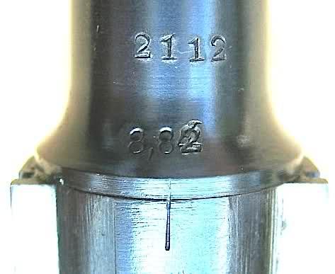

    That's the actual bore diameter.

    I thought I'd gone over my 1910 DWM pretty well over the 40 years I've owned it and I'd never noticed that stamp before now. It's on the flare and just never jumped out at me......

    I believe 8,81 thru 8,85 was within bore tolerance. Apparently they were pretty anal about their bore markings, as this 1911 dated DWM P.08 was first marked with 8,84 and then the 4 was over struck with a 2.

    That really is strange. I guess that if one is interested in Lugers, you have to be prepared to be surprised. Great witness mark on that barrel. Probably has the original barrel.

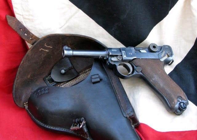

    My Imperial Luger with holster
    1918 luger. WWll holster. WWll magazine marked PO8
    These came with the sale. Dryse Model 1907 .32 ACO and Haenel Shmeisser Model 1 .25 cal

    Your pics, are pretty good. From what I can tell of them, the pistol doesn't look like it went through a refurb/refinish. The stamps are all nice and sharp. Nice find. In Canadaicon, those P08s, with four inch barrels have become prohibited. For a while, until people actually read the law, in regards to inheritance, they were selling off very cheap. Many, that had become valued collectors items, were taken to the range and shot. Some, quite extensively. Then, it became known that if the short barreled pistols, had historical significance and were made before 1945, they could be bequeathed to a non eligible person. That is a good thing. The people that were grandfathered are getting long in the tooth and we feared pistols, such as yours, were doomed to the smelter or if lucky a trip across the US border, all legal of course.
    Now, as this is not really a problem anymore, the prices have skyrocketed again. A pistol such as yours, would fetch $1000 to $1500+ Canadian.
