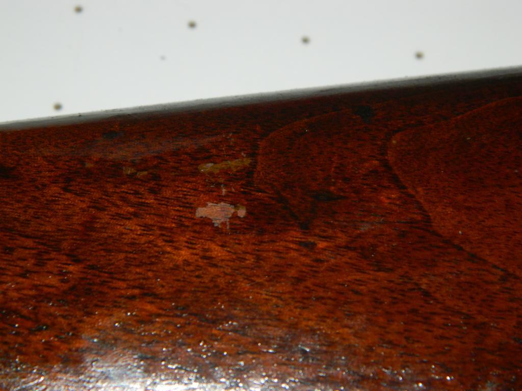

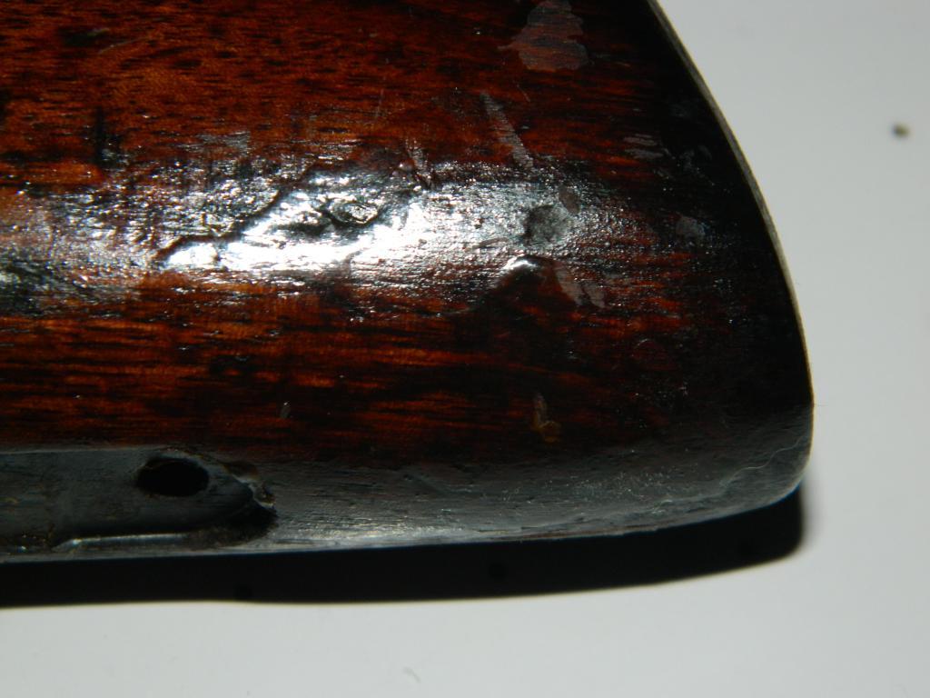

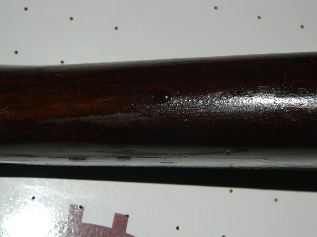

    Been lurking around here for quite a while enjoying everyone's projects and I finally decided its time to clean up one of my guns. I picked up No 4 Mk 1 a couple years ago and the previous owner (or someone before him) put a heavy dose of varnish on it and there are drip marks and heavier layers and thinner layers all over. So I thought it was time to remove that and re-seal it.
    My question is what would be the best way to remove this varnish without damaging the wood underneath and losing the character? What would be the best thing to use to seal it after? I have some ideas but thought I would ask the experts! Hopefully you can see what I'm talking about in the pics.

    Thick, gungy varnishes are easy to remove. The prominent chip in the second photo of the first post shows that the varnish has hardly penetrated the pores of the wood. That stock should clean up like the example below - if you do it my way.

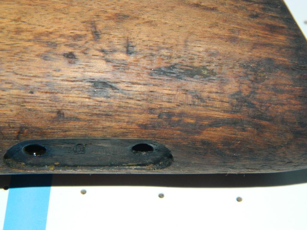

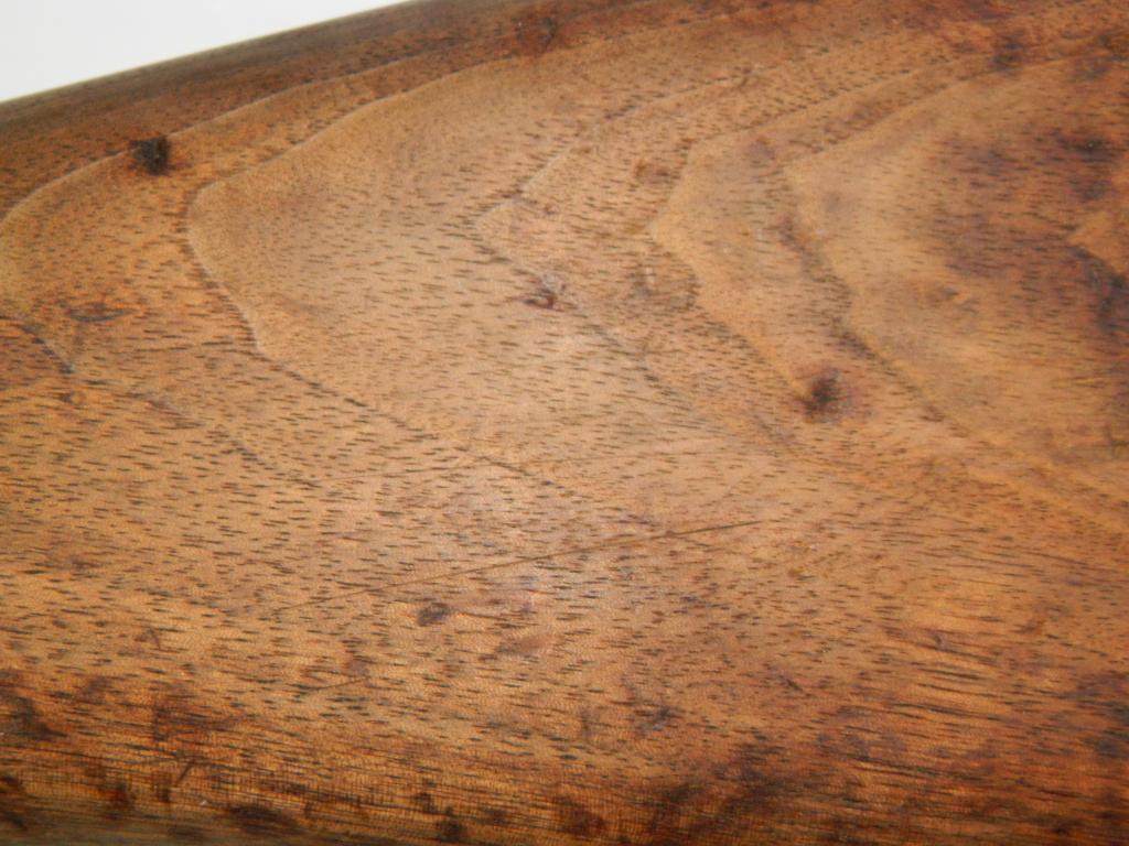

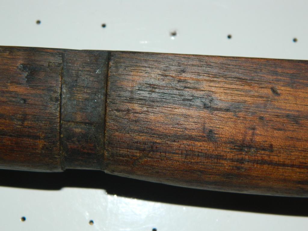

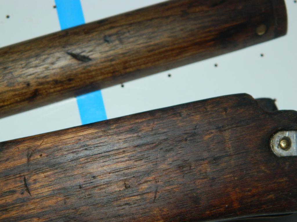

    Okay so I have taken some of the advice here, which I really appreciate. I ended up using a green furniture stripper (because it is milder), 0000 steel wool, methylated spirits to wipe it off and lot of elbow grease. Here is how it looks now. Keep in mind I haven't applied the BLOicon yet but wanted some opinions as the whether you think I should do a little more work on the darker areas or if you think that I'm better off to leave it alone. Looks much better already though.

    It looks much better, but as a first reaction upon seeing the lower photos I'd think that removing some of the old oils that have penetrated into the wood would help. In my area, just leaving it in a closed vehicle during a sunny day (in a month or so) would drive out a fair amount of oil during an afternoon. Say 140°F/60°C for four hours? Then linseed oilicon. Raw linseed oil or as second choice, BLOicon. Don't fret over the dark areas too much.

    Downwind, it's looking good. As jmoore said the dark spots are old oil/cosmolineicon. To remove it from the wood you need heat here's how I do it in the winter months here in Pennsylvania.
    Supplies = your wife's iron... Rags .... pot of water.
    The object is to steam the crud out, dunk your rag ring it out. Place on a spot and apply the iron for a few seconds. You will be amazed at how well it works. You'll get the feel for it pretty quick. Another benefit of this is it pulls all the chemicals you used to strip it as well and removes dents. When your done hit very lightly hit with 220 or 320 grit sandpaper to knock down the few raised grains. I should note be careful around any cartouches as the steam will raise them. That's my short & sweet 2c
