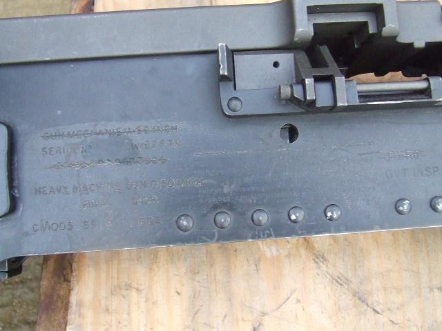

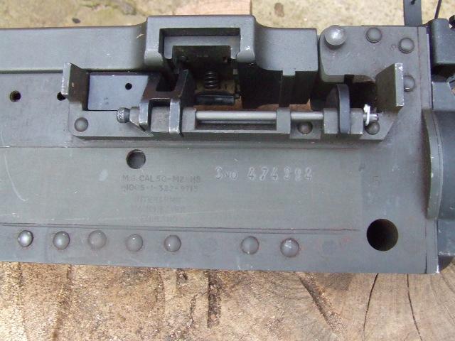

    Heres some time served M2s, ex ranging guns and one which has had the original manufacturers markings removed (Looks to have been of Fridgidair manufacturing).
    I know from my visit in 2010 that there is a M2HB on the AA 4 legged mount thing outside the Royal Enginner/RAF regiment building at mount Pleasant, I believe it may be ex Argentineicon though.

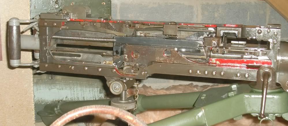

    And because I love sectioned guns, here is my sectioned M2
