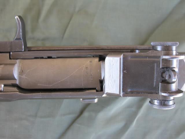

    Guts, there are two articles on the markings, one by Tony Giacobbe in the Spring 1993 GCAicon Journal and another by Tony Pucci in the Fall 1993 edition. This is a photo of the mark on my Mar. 42 .
