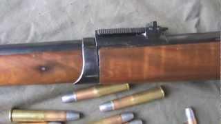

    Werder M1869 Infanterie Gewehr
    New video of shooting my Werder M1869 Infanterie Gewehr.
    This rifle was converted to fire 11x60R Mauser ammunition in 1876 (originally 11x50R ammunition)
    good luck guys.

    Quote Originally Posted by slovakia View Post
    good luck guys.
    It is beautiful, thanks for letting us see the video.
