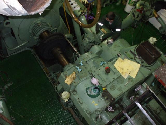

    On the subject of gearbox,s and VW,s, this gearbox is a bit of a hand full and sound a bit crunchie when someone drops a 13mm ring spanner inside !!! the bloke is leaning over the main shaft to the prop, his right hand is under the fixed gear Lube oil p/p and the shaft with the coupling on is the drive to the shaft alternator.

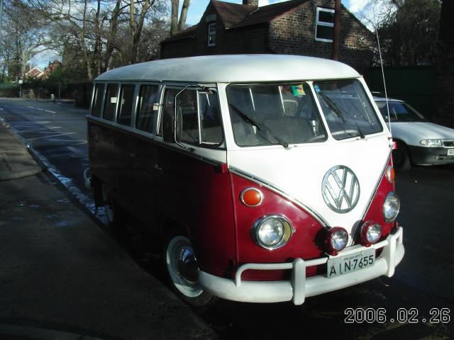

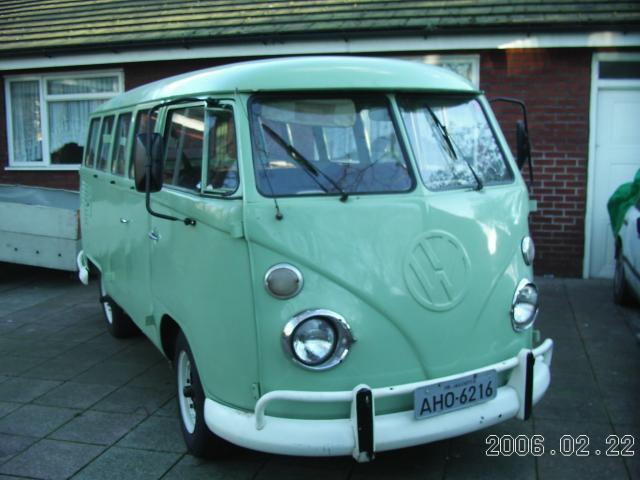

    And a few pics for the VW combi fans, these two I imported from Brazilicon, were the splitscreen was still in production until 1974.
