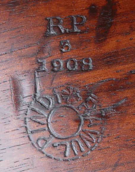

    I have owned this Martini mk4 marked for the NWMP, for around 20yrs. I know very little about it.
    I've seen one other of these, at a gun show in Oshawa, Ont yrs ago. I understand they were police sharp-shooters rifles issued in limited numbers to the police. I'm interested to find out any info on the gun, and would appreciate hearing any comments from anyone with any knowledge of these rifles.
    Regards Ian

    Did you mean to attach photos? If so, I am not seeing any. What sort of NWMP markings does the rifle have?
    If it is a Mark IV, as you say, I doubt if it is legitimate, since Canadaicon never acquired any of that model, to my knowledge. "Arms & Accoutrements of the Mounted Police, 1873-1973" indicates that the only Martini-Henry rifles issued to the NWMP were 10 Mark I rifles in 1874 and then another 10 rifles sent to Prince Albert by the Militia Department in 1895 for use in competitive rifle shooting by Force members. The first ten came from the batch of 2,100 Mark I rifles the purchased by Canada in 1873 (received early 1874) and the other ten could have come either from that batch or from the 5,000 Mark III rifles purchased in 1885. This circa-1896 photograph of the NWMP shooting team shows them armed with Martini-Henry rifles, which clearly do not have the very distinctive Mark IV receiver configuration and extra-long lever -

    Hi GrantR,
    Thanks for your response, I will happily post some photo's, I'll get my wife to take them as she's good at it, and I suck.

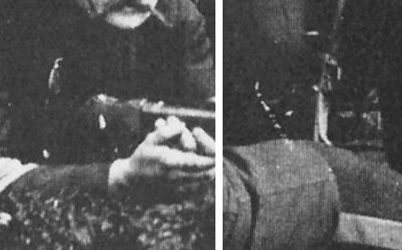

    I've seen this photo before but never so clearly, thanks, if you look at the Sargent sitting below the corporal on the left, I would say he is holding one of the mark IV rifles looking at the length of the lever.
    The stamp is on the butt the typical pressed in roundel type, N.W.M.P. and the date. You will be able to see it's quite clear, when I post the photo's, asap.
    I once saw a guy from Alberta Displaying his rifle at the Oshawa, Ontario Gun show about 20yrs ago, and he had the exact same rifle on display, stamped just the same. He was a lot more informed than I, and told me that four of these rifles were obtained and used as sharpshooters rifles. I believe he had this photograph and a couple of others on the display. It was a travelling effort put on by the RCMP. That's the limit of my Knowledge.
    Regards Ian

    Ian:
    The rifle being held by the Sergeant is clearly not a Mark IV, as the lever is definitely not long enough for that. If it were a Mk IV, the loop of the lever would actually be well out of sight behind the prone man.

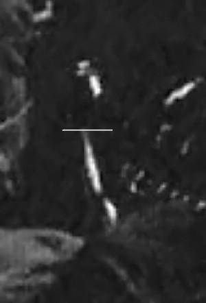

    The glint of light off the front of the triggerguard of that rifle creates a bit of an illusion of a somewhat longer lever, but most of the triggerguard is in shadow ..... I have drawn a line in this detail cropped from the photo, denoting the rear of the triggerguard (and thus the forward end of the lever) -

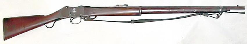

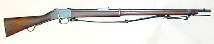

    As you can see, the length of the straight section of the lever between the triggerguard and the loop is definitely of sufficient length for the rifle to be a Mark IV, as seen here above a Mark III for comparison -

    Hi Grant
    Hi,
    I went and dug out the 3 that I have the Mk IV is so long I'd forgotten how long, the other two I have are the Mk III BSA in 303 and a Greener which has a much shorter looking lever, and what I have out.
    Anyway the branded mark is on the RH side of the butt marked N.W.M.P. POLICE, it's a MKIV 1 there is another smaller round mark behind the police stamping but I cannot read it. The wife say's she will snap it tomorrow morning. The M is not clear as something hit the stock at sometime in it's life, but the rest is very clear, and as typed.
    Regards Ian

    Hi Grant,
    Thanks for taking the time to extra enhance the photo's, I've had my two rifles out and compared them today with the help of a friend, and I hate to say this but I'm becoming more convinced that the Sargent is holding a mk IV. The higher glint on it is from the trigger guard, then it goes into the shadow, and the remaining glint is the long lever, which I think is the only way this is explainable. As with the shorter, and thus more angular lever it looks quite different. Only visible because it falls in the hollow of the guy's back just above his backside. The Rifle I own is a sergeants model by the way.
    Like I say in the little blurb, it may well be wishful thinking on my part, it's hard to say and just to add to it,in my comparision one lever I'm looking at is blued (the long one ) and the other clean shinny steel.
    Anyhow Thanks for all your time, I did think it was just a fish story on my friends part, when trading the rifle to me. Until I ran into the display at the gun-show and he relayed the same story. How did they win so much, with those crappy sights.
    Take a look at the photo's, the wife did her best, she took loads more, so let me know if there's anything else you would like. Thanks again.
    Regards Ian

    Sorry Ian, but the Sergeant in this photograph is not holding a Mark IV, although I realize you want to convince yourself that he is ...... Look at the size of the triggerguards in the two side-on rifle views I posted and you will realize that the "higher glint" in the old photo is light reflection only from the front curve of the triggerguard in the photo, the bottom and back curve of the guard are not reflecting light. The straight part of the lever starts about where I have put the white line.

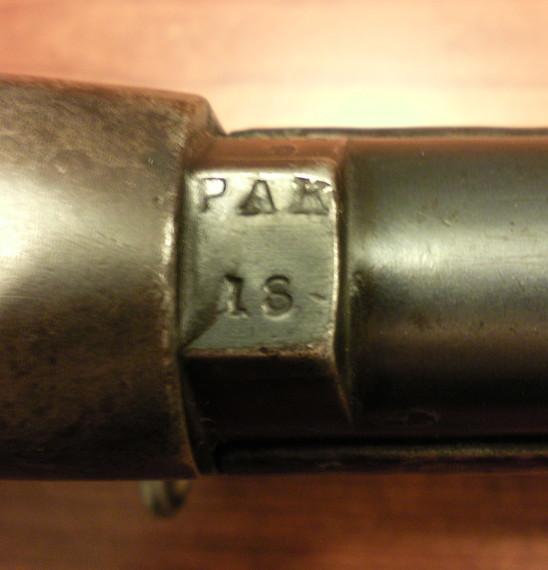

    I hesitate to post further in this discussion, because you so clearly want to believe that your Martini-Henry Mark IV was North West Mounted Police issue. However, I regret to advise that the roundel in your photos is not an NWMP mark. You indicated that you feel this rondel says "N.W.M.P Police" but, to my knowledge, the Mounted Police have never used a combination of all of the letters in their abbreviated name with the word "Police" - it would have been either "N.W.M.P" or "N.W.M. Police". At any rate, it makes no sense that a small number of Mark IV Martini-Henry rifles be acquired for the NWMP when Canadaicon held over 7,000 Mark I and Mark III rifles .... most of which never saw military service, but were extensively issued or loaned out to both military and non-military competitive shooting teams.
    I am satisfied that this rondel in fact is "N.W.F.P. Police" - referring to the police force in what was the North West Frontier Province of Pakistan. (In 2008, Pakistan changed the name of the province to "Khyber Pakhtunkhwa", purportedly to get away from "imperial/colonial" connections.)
    Most of the other markings shown in your photos - other than the original markings applied at Enfield - show clearly that this rifle saw its service in Pakistan. For example, the "PAK" mark on the nocksform is well known as denoting service in that portion of the Britishicon Raj.
    Similarly, the R.P. mark on the buttstock is also a very well known mark denoting the arsenal at Rawul Pindi (the modern spelling of which is usually "Rawalpindi") -
    I expect that I have no real chance of convincing you, however ....

    Hi Grant,
    I'm sorry I gave you that impression, I've looked and looked at that photo and it is hard to see. I must thank you for all your time, patience and effort.
    When I acquired the rifle there wasn't any readily available information, and as I knew the guy who traded the rifle to me, I took it at face value. Then I was only interested in the bore condition, and not the gun story.
    In all honesty, there was an M looking letter there, but then with the damage being thru the crucial letter, maybe that was the reason.
    I only gave the story any credence, when I ran into the other character at the show. As I'm more of a shooter than a collector, especially back then when I only wanted to play Zulu.
    Now I just thought, I would try and find out once and for all, as it's time to decide what I'm keeping, also the stock needs fixing too now.
    I think you have more than made a convincing argument, with the explanation of the other marks to, which I appreciate.
    All my other early Canadianicon guns, have the DC in a diamond stamp, which this doesn't, but I wasn't sure if it should, I suspected it probably should.
    I have a prison service or provost marshal Snider, which is clearly marked with a stamp.
    Anyway, I thank you very much for your time, shame about the glint in the photo, which from my perspective really made it look like the rifle, and it would have made for a good story, oh well.
    One more question if you don't mind, would this have been issued to Britishicon troops or local troops, like my Citadel 303, as this would explain the poor outer condition.
    Regards Ian
