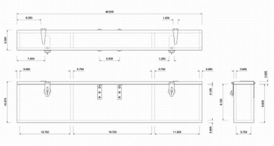

    Is this a Bren or a No4 transit box/case?

    A Bren transit case is wider.

    I have a complete set of plans for a No4T transit box somewhere. That looks to be the same IIRC. Will try to find the drawings if anyone interested.

    The width is right for a Enfield chest, but the height is what looks out of whack.
    If the box is for a Cno7, then it would be about 7.5" high. If it is for a 4T, then it should be 9.5" high. Your plan shows 16.5" high.
    Similar boxes were issued for all sorts of Brit equipment, including Vickers MG, Vickers tripod, mortars, and there even was a post war version for the Cdn sterling C1 SMG.

    Quote Originally Posted by stencollector View Post
    The plans list 9.XXX and 0.XXX for the lid thats a 10 not 16.
    Got a better picture of that ??

    Yes, I was worried about the size.
    Attachment 20255
