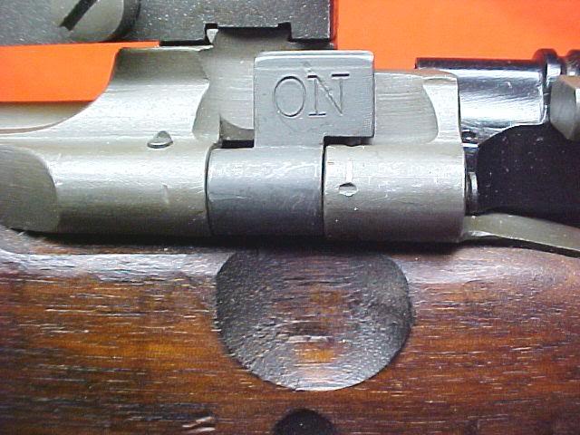

    06-07-2023 @ 08:25 PM
    474
    05-05-2025
    10:43 PM
    Note how the edges of the same notch are rounded; they should be sharp, like this:
    The stock has been "lovingly sanded & refinished".
    Neal
