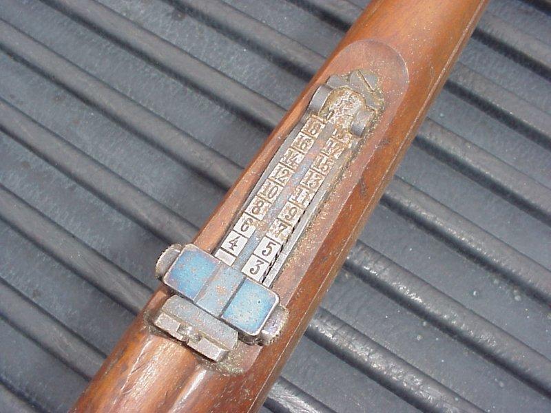

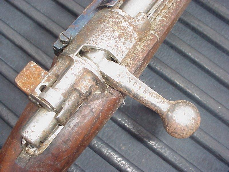

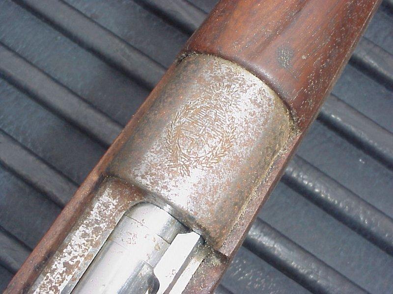

    1909 Argentineicon, all-matching and was probably imported in 'unissued' condition. Then rode hard and put away wet.
    First you cry. Then accept it for what it is and get down to work. It will never be pristine again. But it is a good representative example and I love it for what it is. YMMV.
    Best wishes. Dave
