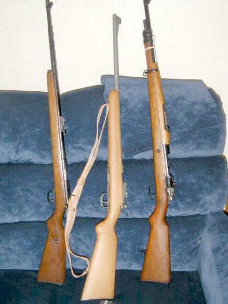

    The 45a was the last trainer of Mauser Company design. The Frenchicon took over the Mauser factory and aked Dr. Harnisch if the remaining Mauser techs could design a training rifle. They based it on the model 37 and KKW. It sounds as though the stock is correct. More info can be found in Jon Speeds "The Mauser Smallbores" Here is a pic of mine, it's the middle rifle:

    Mine is a MAS marked rifle. there was also a transition rifle with both markings on the receiver, Mauser Mod.45 and MAS.
    I've never shot mine as it appears to be unfired. Others report that they shoot a bit high. It is a nice collectible and should look like the one I have except for stock color. Some may have darker wood.
